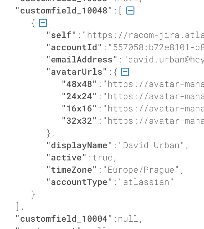

thank you for lowercase suggestion, I tried, sady it did not help. Here is a piece of JSON API I took the info from:
It clearly is the field I am looking for. Could you maybe try on your instance? Just to confirm?
Here is the full JSON, I made a screenshot of only the important part. I need email address of person save I’d field “Quality Assistance”:

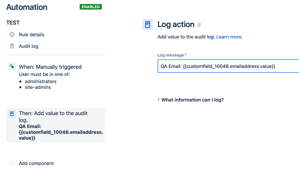

Thank for suggestion Bill, sadly it still does not work. Here is the test Rule I use to display email in log:

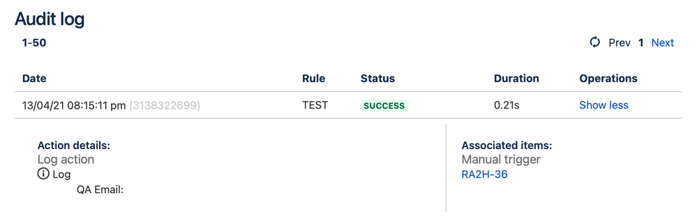

And log result:
As you see, email does not get logged.

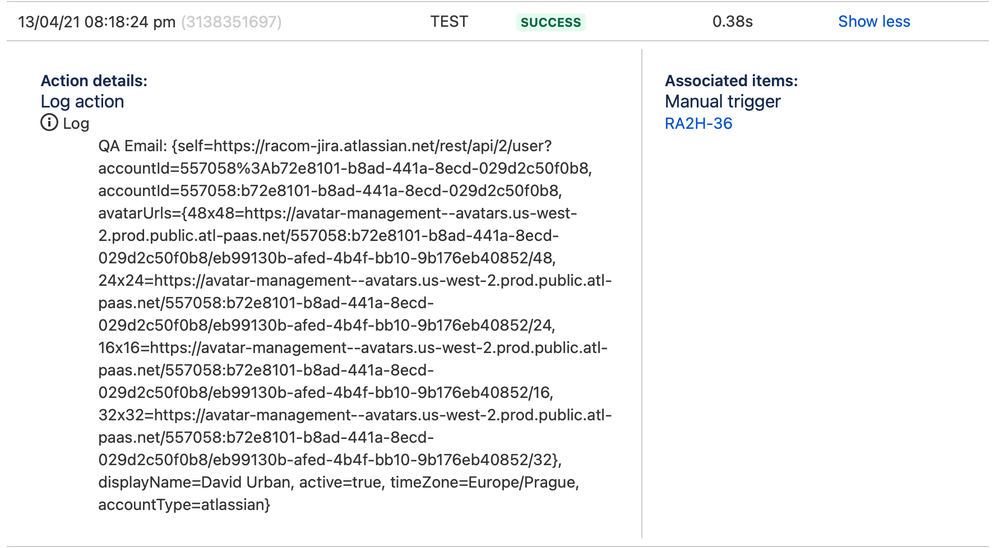

If I log the whole object {{customfield_10048}}, here is the result:
Even though email gets displayed in JSON API, it is not displayed in Rules… I have no idea why.

Hi @david-urban
Smart values are case-sensitive, so please try that again with emailAddress. Thanks!
__Bill
