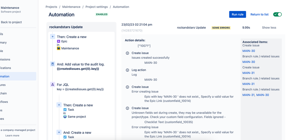

I am trying to achieve basically this topic:

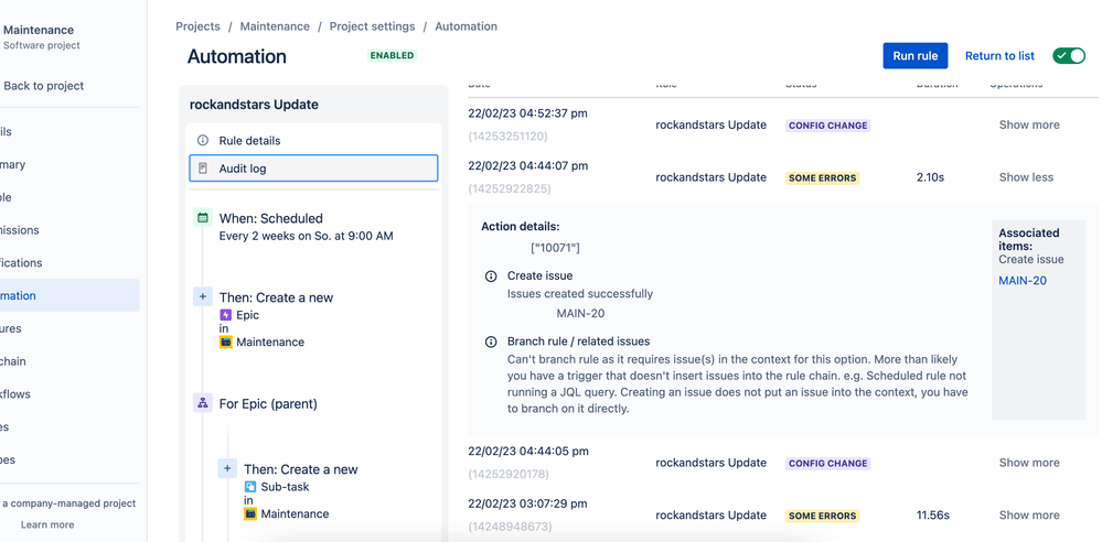

only difference is I dont have Storys, I just want to create sub-tasks to an epic. I tried to use the solution of this topic but I must have done something wrong.

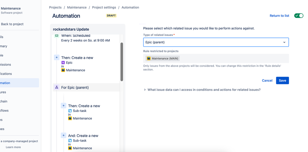

The reason for the error in your automation rule is improper use of the Branch component.
When you use "For Epic" what you are asking the rule to do is to shift focus to the parent Epic of the issue the rule is currently executing against.
Since the rule is triggered on a Schedule, and I assume that the trigger does not include a JQL statement, there is no issue from which the branch can shift to a parent Epic.
You can't use that branch to take action against the Epic you just created.

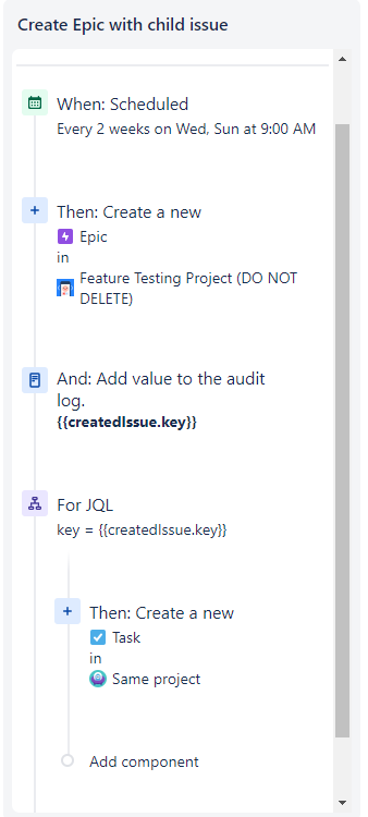

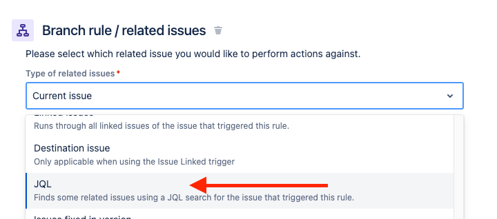

As shown in the Answer in the post you referenced, your branch would have to be defined thus:
branch: on JQL with key = {{createdIssue.key}}

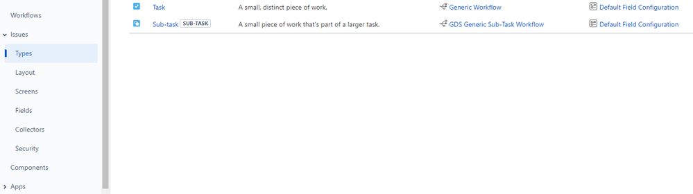

Hi, welcome to the community!
I can't see the details on the create sub-task action from the screenshot. But if you are trying to create a sub-task issue type with the epic as a parent, it is not possible.
Epics can have child issues, but there are main-level issues, which then will have their own subtasks.
Issue hierarchy by default is
-Epic Issue
- Issue (e.g. Story)
-Sub-Task issue
If you do not have the "Story" issue type in the project, you can create other issue-level issue types that may be available (e.g. Task) using the Epic as a parent.
Check what issue types you have available in the project. You should have Epic and some others. If an issue type has a "sub-task" tag in front of it, then it can't be created with epic as a parent.
The image below shows the Sub-Task and Task issue types on a project. In this case, you could use automation to create a "Task" with the new epic as a parent, but not a "Sub-task"
Thank you for clarifying. How would I bind a Task to an epic in Automation then?

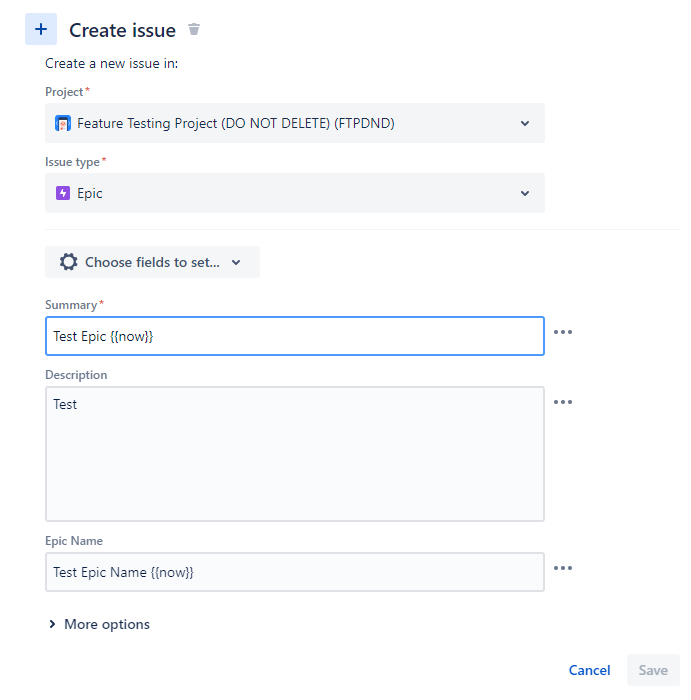

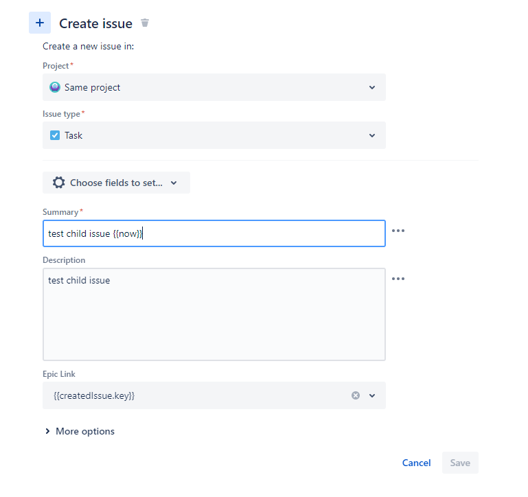

Here is what I used in a test project to create an epic and a child task on a scheduled trigger (I used generic names, summaries and descriptions with timestamp {{now}} ):
Rule Map:
Detail on creating Epic Action:
Detail on creating Task action (child issue to the epic)
Hello again,
I just tried this and got this error which does not make any sense?
I mean it creates the Issue and then claims it does not exist?
I solved the error by using this way:
Most recently created Issue
and
{{issue.get(0).key}}
Sorry - scratch the last part.
{{createdissues.get(1).key}} is the correct way. Tasks didnt get linked to the epic.
