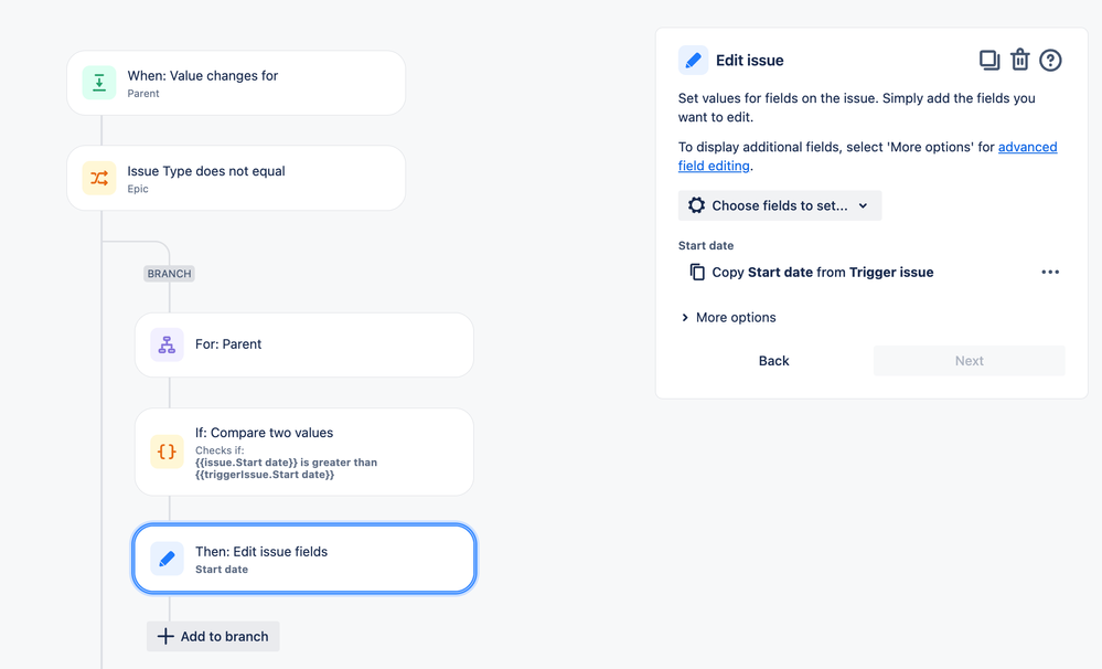

I did this by comparing the start date of the trigger issue and the Epic. If the trigger issue's start date is less than the Epic's start date or the Epic's start date field is empty, it will copy the trigger issue value to the Epic.
However, I think the lookup issue action will be more precise. If I use the current method, even the system copies the value from the child issue, but we cannot guarantee that the date is the earliest date from the child issue.
I tried to use Smart Value Comparision to compare the original Epic ({{#changelog. epic link}}{{from}}{{/}}) and the new Epic ({{#changelog. epic link}}{{to}}{{/}}), and lookup the value from the new Epic if a child issue added in it. However, it doesn't work, and it seems the lookup action didn't support the Start date field. So I'm still figuring out how to read the child issues' Start Date when an issue is removed from an Epic.
