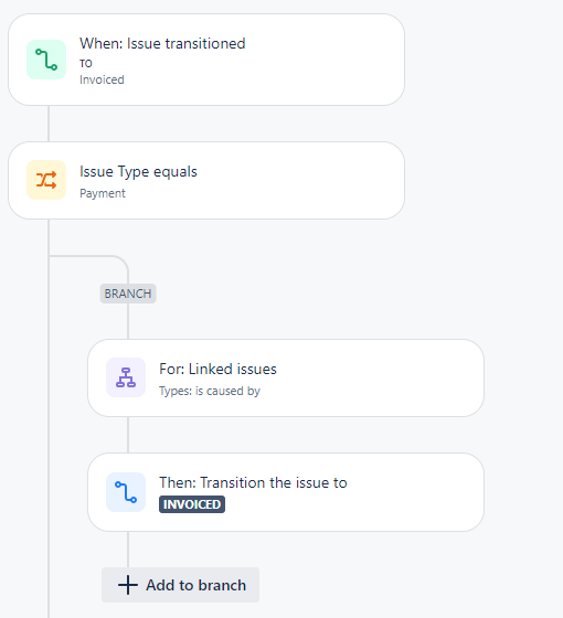

I'm attempting to create an automation that updates a linked issue when the trigger issue is updated to a specific status.
The issue is that this automation does not work. The linked issue is not being transitioned automatically.

Hi @Caressa
The rule looks correct, assuming the logic is...
So the issue the action is taken against should be linked to the trigger issue using the "causes" link type.
Could we also see the audit log, to see what is happening when it attempts to execute?

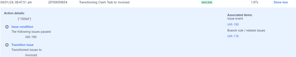

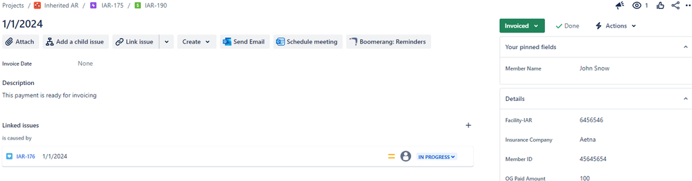

IAR-190 was transitioned to "Invoiced" so according to the automation I've built, IAR-176 should automatically be transitioned to "Invoiced" as well but it won't.
IAR-190 meets the automation condition of Issue Type equals payment
IAR-176 is linked as a "is caused by" link

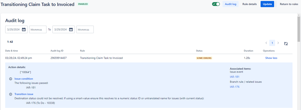

Hi @Caressa
The error in the audit log states IAR-176 cannot move to the destination status, so either...
^ Could you check these 3 issues, and see if this helps clarify the problem?
