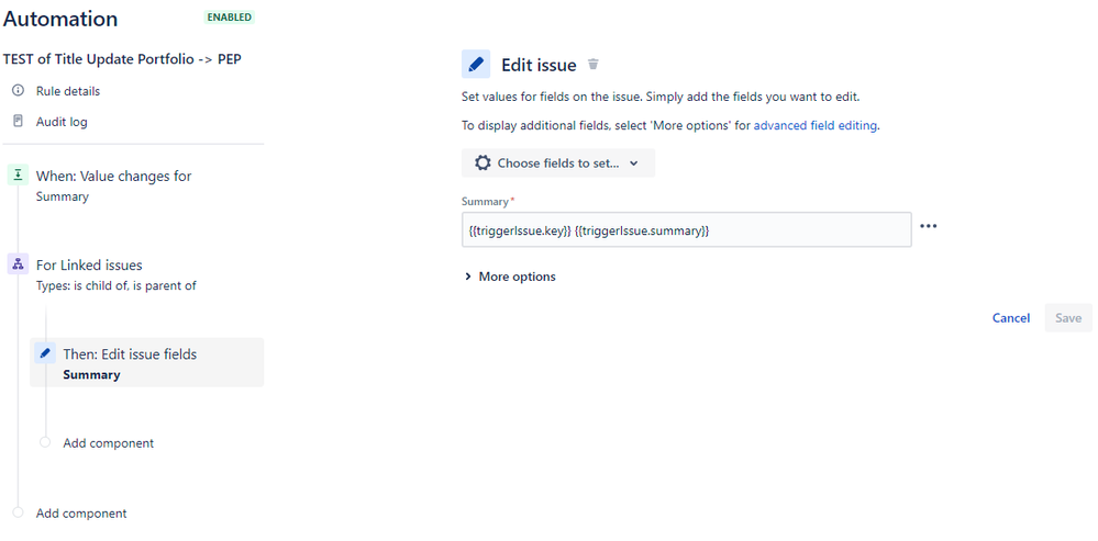

Hi @Martin
When you note "help with JSON automation", what do you mean? How are you making the update?
If you used an automation for Jira rule, the edit action should allow you to set the updated summary with:
{{triggerIssue.key}} {{triggerIssue.summary}}If I am misunderstanding your request, would you please post an image of your complete automation rule to provide some context? Thanks!

Hi @Bill Sheboy , thank you for your answer.
Yes I say json because I think that's what you need to build with the custom automation code under More options.
Here is the screenshot of the automation that works for now.
@Bill Sheboy thank you for your help, you made it work!
