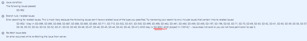

When deleting an epic, there is a field that requires editing in its children. Trying to use a branch "Children" OR "JQL" in combination with lookupIssues unfortunately doesn't work because while using a branch a "key != ({{triggerissue.key}})" is added in the backend of the branch so that it only returns related issues (not including the current issue).
A JQL with a deleted issue is not valid, hence the error. SD-902 is the deleted issue that triggers the rule in the snip attached.
Is there any other approach I could follow? :)

By the time the Issue Deleted trigger fires for a rule, the issue is gone and the links to the child issues are cleared.  Although the rule has the deleted issue's key, that cannot help for finding the child issues (as you observed with JQL).
And...I do not believe the Issue Updated or Issue Field Updated triggers can be used to accurately detect the clearing of the parent field to find the children.  Seems to be either a timing issue or a difference in which events are fired.

SD-902 (Epic) Deleted by a user. Then using a branch to reach its children and clear some field values that shouldn't exist in stories without epic.
