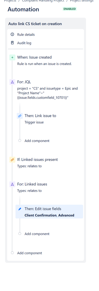

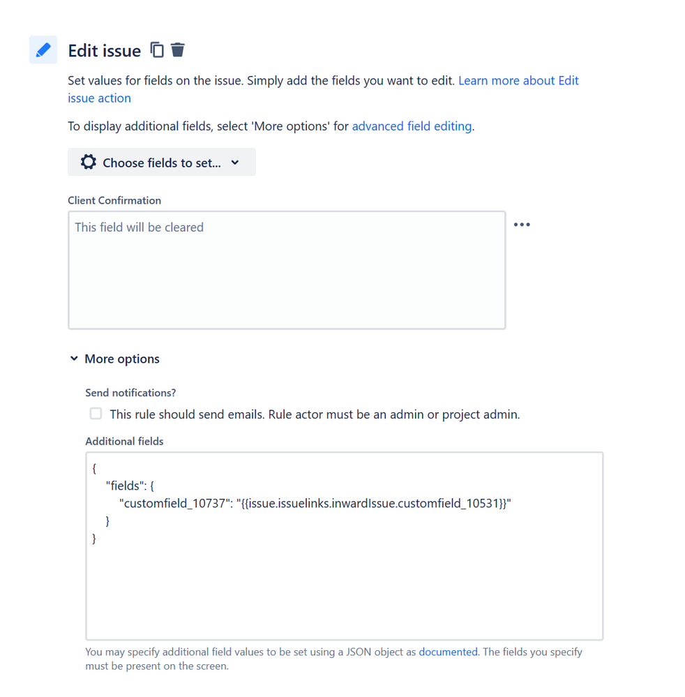

The rule has changed slightly from when I first created it. I changed "relates" to a new custom verb "satisfies". Other than that it should be essentially the same rule. I added several custom fields I needed copied, but it all works. Note in the second screenshot I had to do both verbs "satisfies" & "is satisfied by". I can't remember if I did both and just never removed one, or if they are both indeed needed. Hope it helps.
