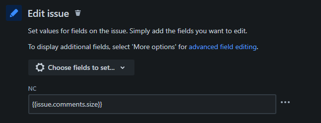

@Ana Laura de Melo not sure if you ever figured this out or not but all you'd need to do is create an Automation rule with the following Edit Issue component.
For me the field is named "NC" for Number of Comments and you're just setting the field value to {{issue.comments.size}}
You can run this on a schedule or you can run it whenever a comment is added/deleted to update the field value.
