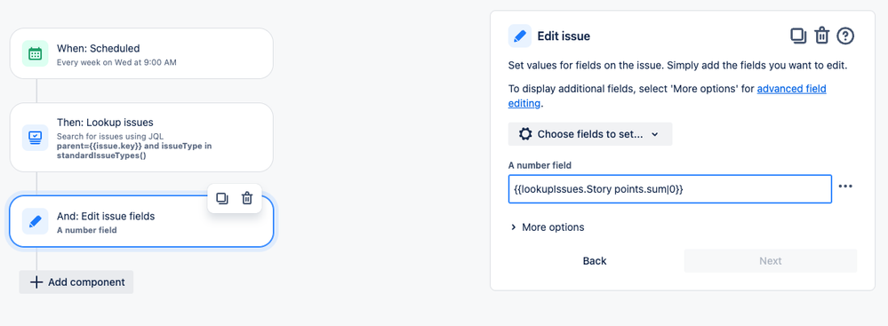

If you want to do a one-time sum up of child Story points to parent Epics that are already in progress, you could do that with a scheduled or manually triggered rule. Here is an example of Scheduled rule.

Hello Jeff,
What value are you using to set the Story points field in the Edit action?
That rule should work for Epics that are "In Progress", since there is no condition that checks the Epic's status.
If it is not working, please share with us the output of the Audit Log from an execution of the rule where you did not get the expected results.

{{lookupIssues.Story Points.Sum}} is the value. Here is the rule and below is the log. I went into a couple of projects (Jira test) and selected a couple of Epics already in progress. Ran the automation in the epic and nothing happened, thanks.
