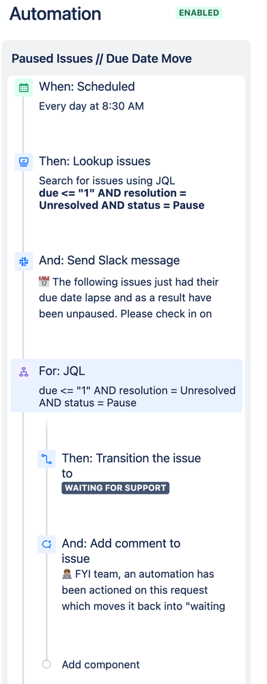

Hey All, I had the same issue and I believe it's because it applies the slack message for on every issue the JQL search finds to apply changes on. So 4 issues found in the JQL = 4x slack messages.
I have fixed it by not having the JQL search in the schedule module but rather have a branch module down the line which includes the JQL search to pull in issues to apply the changes to. I have the lookup module ahead of this and I now only get the single slack message.
Basically you want the lookup issues module ahead of any JQL filter 👌🏻
This screenshot will help explain:
