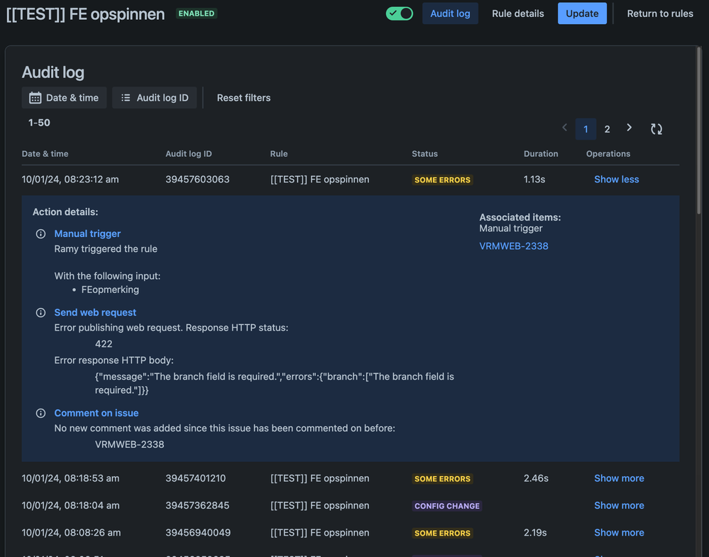

I’m hoping someone here can help with an issue we’re encountering with an automation rule in JIRA. We’ve set up an automation that should capture the name of a branch when it is created and store this value in a custom field within the linked JIRA issue. This step is crucial for us, as we need to use this variable outside of the initial automation, specifically in a webhook integration.

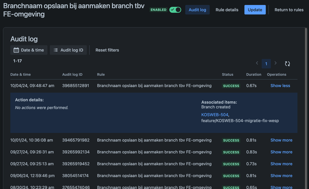

The automation rule appears to run smoothly—each time it’s triggered, the audit log shows that the rule has succeeded.
However, the result is always an empty variable in the custom field. This is causing us some headaches, as the empty value leads to a failure (422) in the webhook.

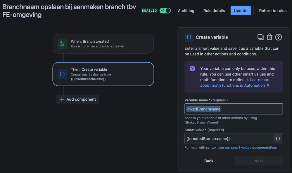

Hi @Ben Wilbers ,
in the documentation https://support.atlassian.com/cloud-automation/docs/jira-smart-values-development/ I can see that {{createdBranch}} Smart Value is used in Bitbucket, Gitlab, etc.
For Jira Trigger they have {{branch.name}}. Could you please try to use {{branch.name}} instead of {{createdBranch.name}}?
@Max - SwiftSprint dev I've tried to use {{branch.name}} instead of {{createdBranch.name}}, to no avail.
