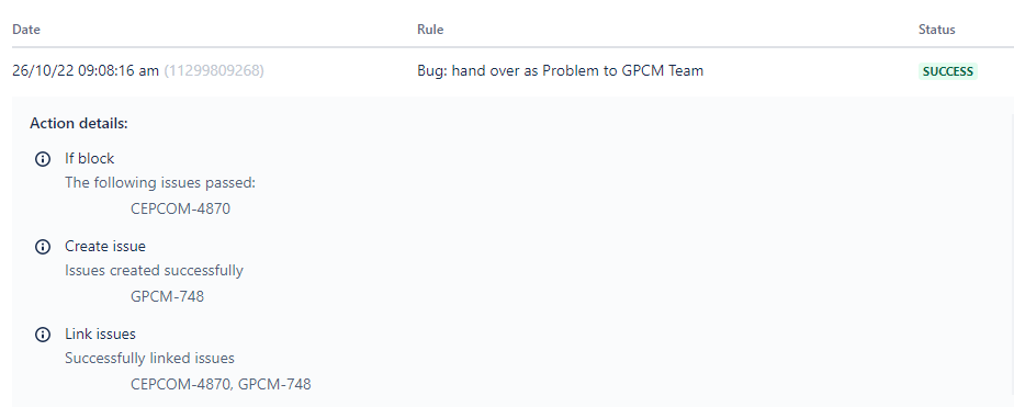

Hi. I built an automation flow that works fine. It creates a new issue in "Project B" and sets a link between the issue in "Project A" and the new issue in "Project B". So, i can see the link but the other users can't see it.
The users are working in "Project A" and have no permission to view "Project B". Is this the reason? I would expect that they can see the link and the status of the linked issue but can't open the linked issue, no?

No. Your assumption that this is caused by the permission to view (issues in) project B is correct. If you're telling users that they don't have access to a project, they will not be able to see issues from that project anywhere in Jira. Not even as links on other issues they are allowed to see.
Hope this explains!
