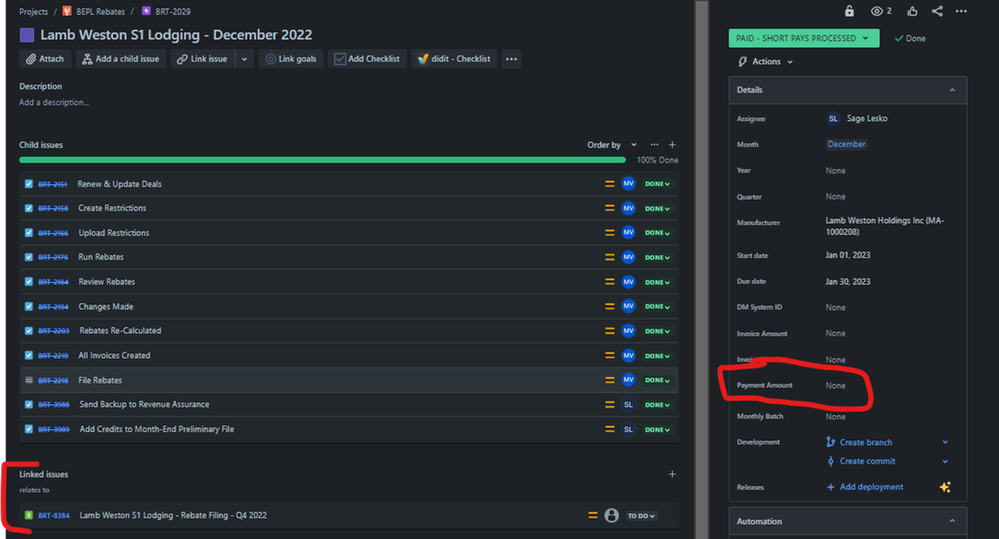

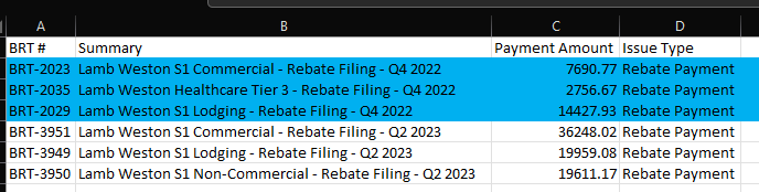

This is my CSV file, where the first 3 issues highlighted in blue did not update the fields in the Epic:

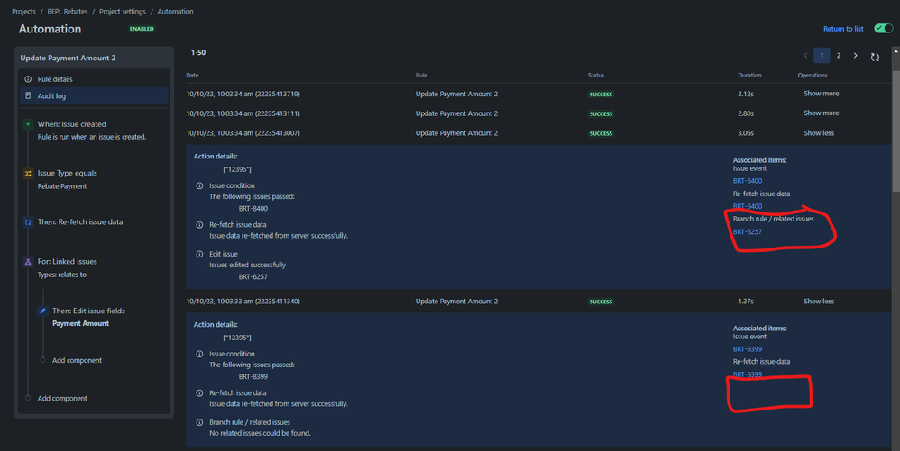

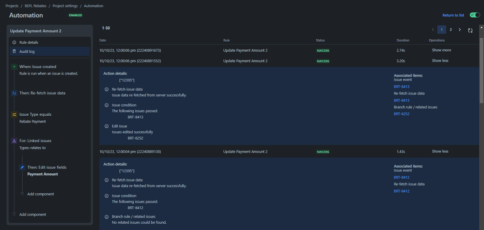

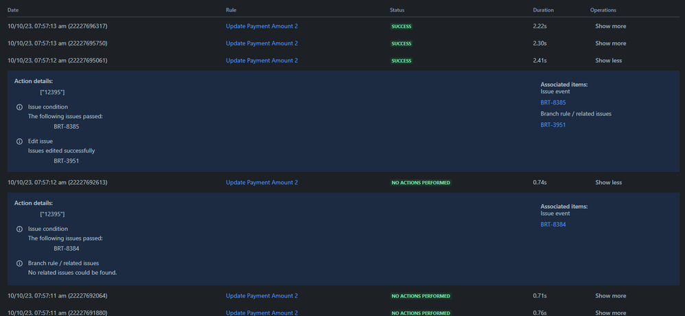

This is the audit log of the automation. I've expanded one of each type of automation: one that was successful and one where "no actions were performed":

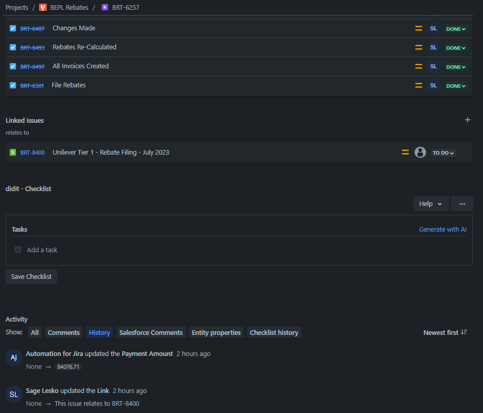

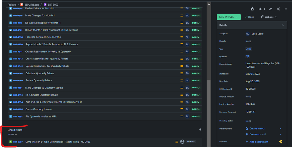

This is an epic that shows the linked issues and updated the Payment Amount custom field:

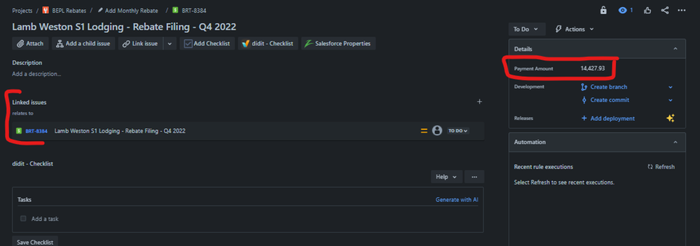

This one shows that it was linked successfully to the epic but the Payment Amount field was NOT updated:
Clicking on the imported issue the Payment Amount was uploaded successfully:

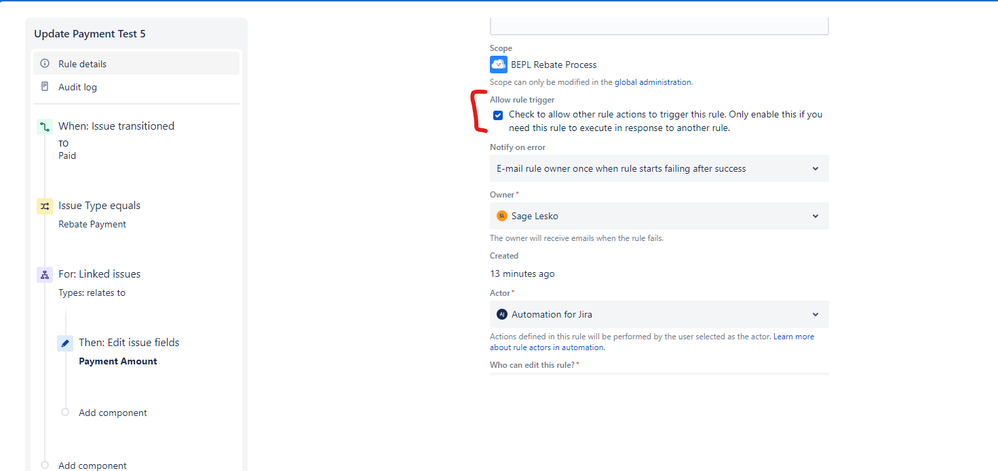

Here's the solution I found:
1. To update the imported issue to a new status
2. Updating the related issue when the status is transitioned and checking the box for allowing other rule actions to trigger this rule.

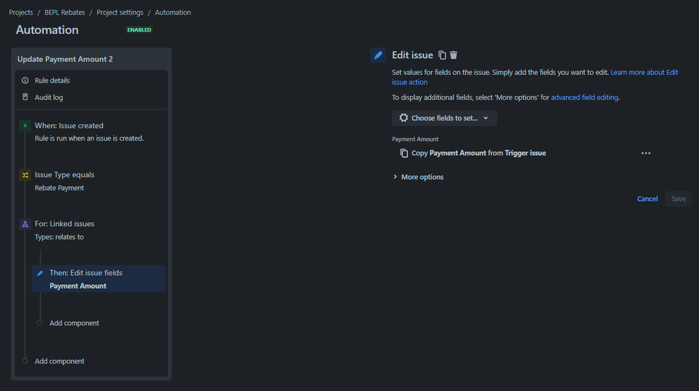

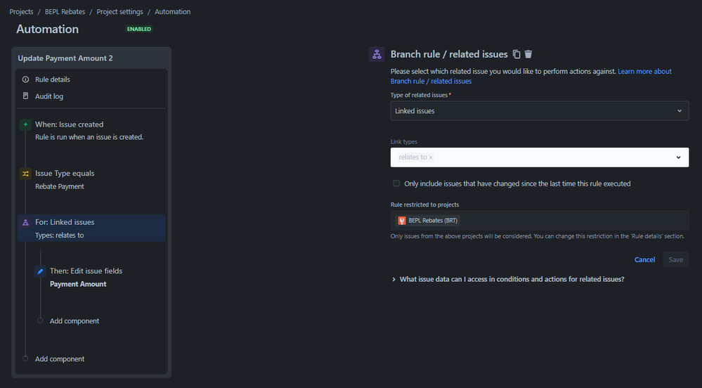

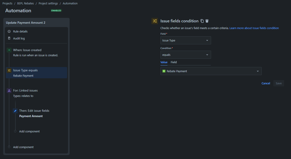

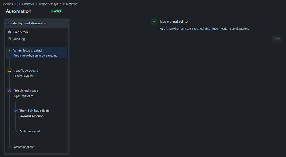

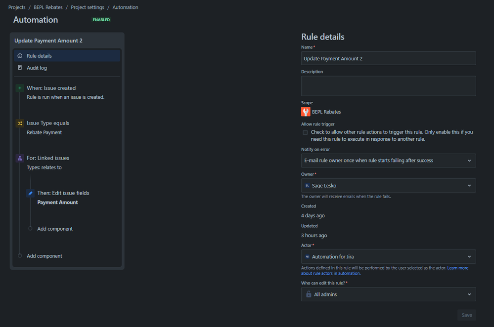

Hi, I answered above instead of replying but here is the outline for the Automation:
Issue Created:
Issue Type Condition:
Branch rules for Linked Issues:
Then Edit Issue:

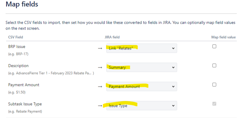

The upload map fields are as follows (screenshot is from another Jira project, so ignore the different Project Key):

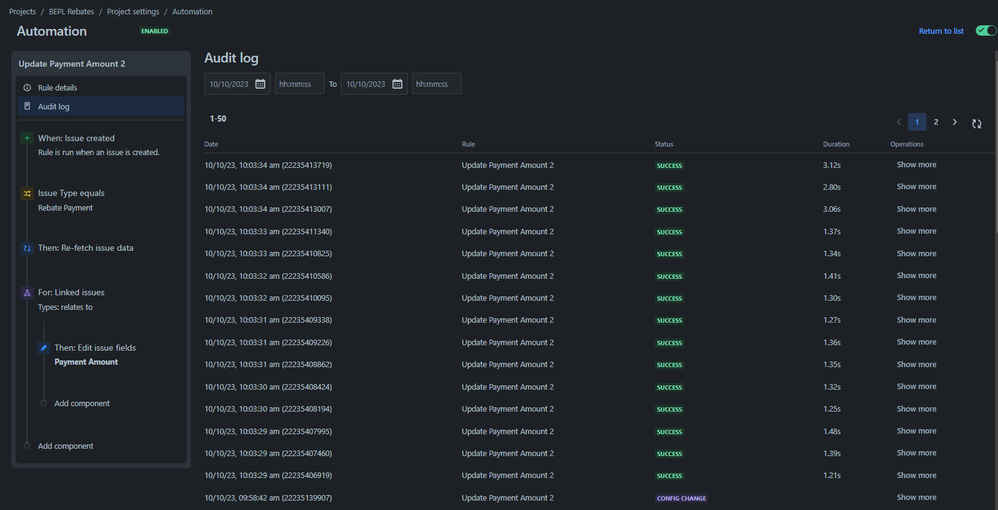

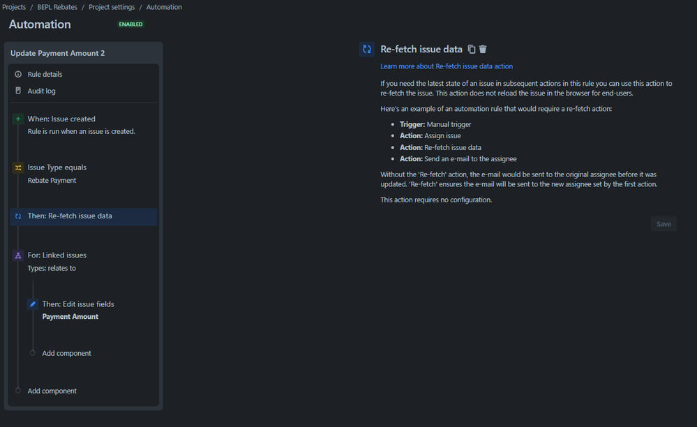

I tried added a re-fetch action in the automation, as seen here:
All are now showing as "successful", but you can see that the automation still didn't "kick in" until the final three rows of the upload file:
Automation Audit Log:
Automation expanded to show where automation did not update epic successfully:

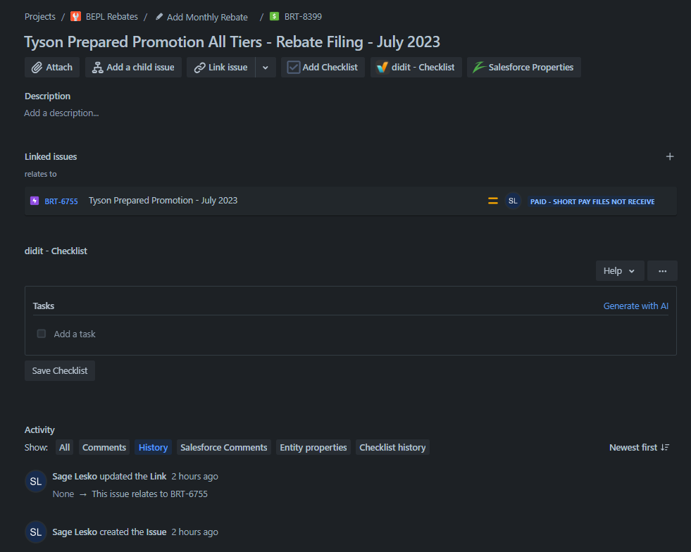

Next, this seems like a timing / race-track condition. Would you please post images showing the issue history (including the create) for one of the issues that worked and one that did not? I wonder if those will show a non-trivial time difference between the create and the linking.
Bill
Hi Bill,
Here is one that was successful:
Imported Issue:
Linked Issue:
"Unsuccessful":
Imported Issue:
Linked Issue:
I updated the order of operations for the automation rule to re-fetch immediately after the Issue Created step, and was still unsuccessful for all imported issues.
Yup, we see two different entries as the link happens separately.
For the created issue, if you hover over the values in the issue history for created versus linked, how much time difference do you see?
UPDATE: I just tried this for an on-line (not imported) issue create and even that one shows two different history entries. (Seems like a design choice / defect to me.)

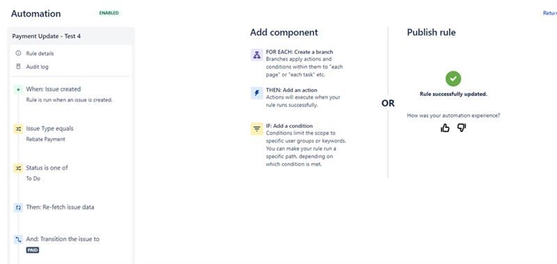

For anyone else curious or looking for a similar solution, I was finally successful by using two automations:

Hi, here is the outline for the Automation:
Issue Created:
Then Edit Issue:
