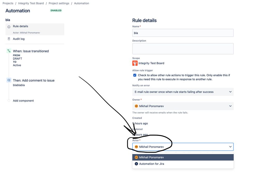

Automation for Jira - seems to be what you mean by "account that runs the automation matters"... May be it has wrong settings as account? Because I can't add it to the Project and therefore I can't add it to Restrictions....
When issue is restricted:
Where I am the Administrator, NO automation work. None at all.
First of all, if I check here in the issue:
I see this weird ERROR:
Second, when I try to trigger Automation rule, the Audit Log of the rule shows me this failure error:
Which is a false statement! Issue is not deleted and I have permission to view the issue (see above - I am the Administrator).
You may think that I also have to restrict issue to Automation for Jira. I don't think that's needed. In my Automation rule - I have changed Actor to myself! So I don't think "Actor" is a problem here....

Not helping… in my automation rules “actor” is me and I am the one to whom issues are restricted….
Automations respect the restrictions on issues, so check who the "Automation user" is - the account that runs the automation matters. You'll need to include them in the "restriction" (I'm not sure what you mean by that though - project visibility? Project permissions? Issue security? Workflow conditions?)
