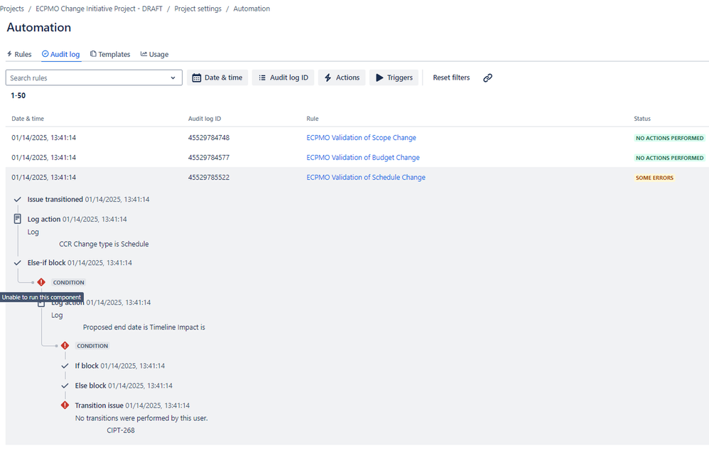

I have 2 automation rules that were running successfully yesterday, today I get an error message 'Unable to run this component'.  Are automation rules this unpredictable?  What would cause a rule to quit working when it hasn't been changed?

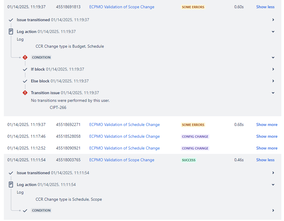

I deleted the rule and re-created it, The rule worked once (11:11:54), then second run quit working (11:19:37) with the same error.  The rule name is 'ECPMO Validation of Scope Change'

I do not see any errors in your rule's audit log; instead it shows conditions were not met and a transition did not occur (which could happen for various reasons).
And does that message "Unable to run this component" appear in the log or in the rule editor?

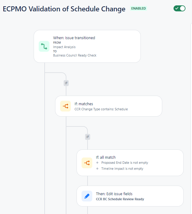

Please post an image of the complete rule in a single image file.  To do that, you may need to use a screen capture tool or browser addon for scrolling page capture.  Seeing the entire rule at once will provide better context to diagnose any symptoms you observe.

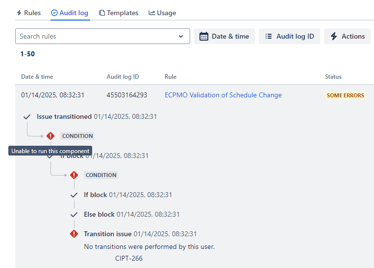

The "Unable to run this component" appears in the audit log.  I don't have access to a tool that will screen capture and scroll - banks are highly regulated and limit our tools.
I put in log action to capture the first if statement value before the error. The expected results is to take the ELSE of the Second If statement, but the first If statement doesn’t process.
The Second IF statement overlaps in the screen prints so you can see I didn't miss anything.image.pngimage.pngimage.png
Ann Rumenapp
January 14, 2025
You are right Bill/Jack it might not be in the rule. Atlassian support pointed out that the workflow transition had a condition of being a member in the ECPMO CDL_CDM group.  I changed the rule actor to myself, a member of the group and now the issue transition will work.
In the audit log I'm getting an error 'The fields set during transition aren't available. Fields ignored: CCR BC Schedule Review Ready (customfield_12812).  Any thoughts on what a rookie like me would do to cause this?
