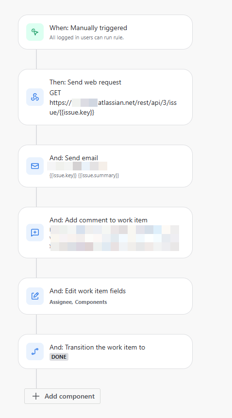

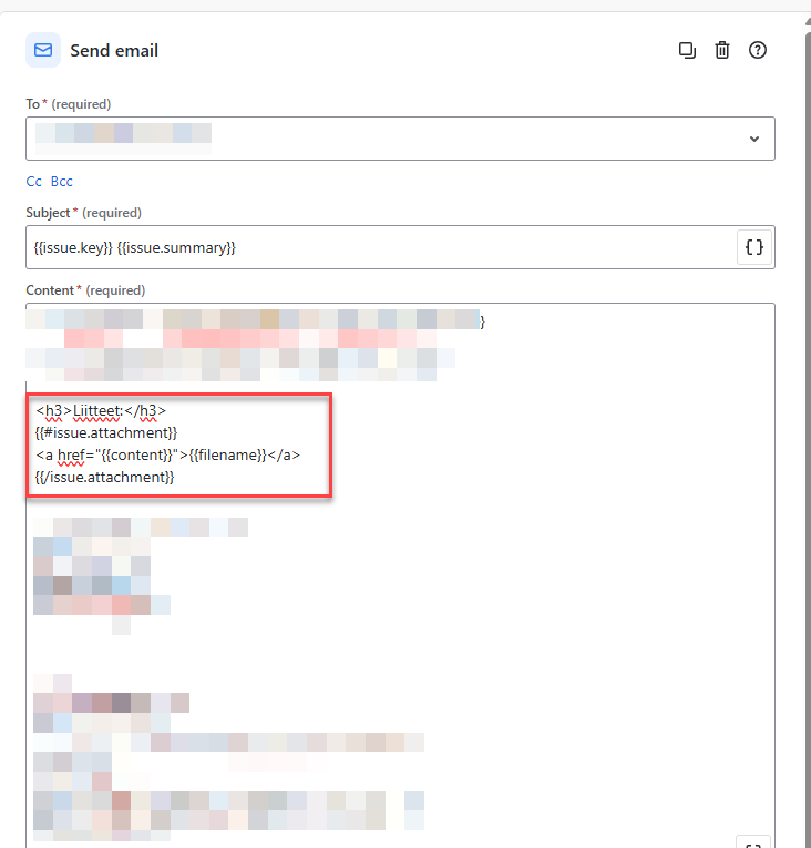

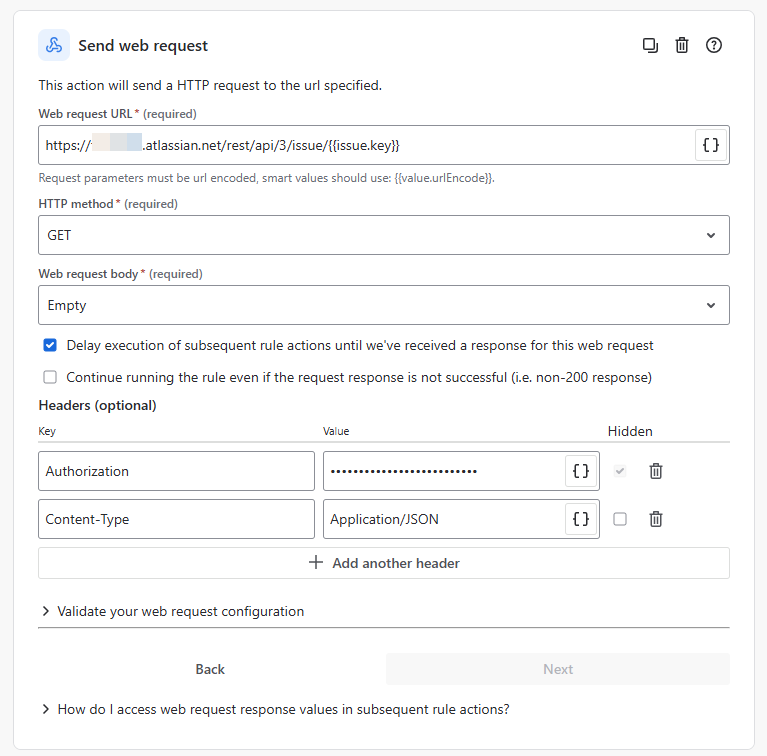

Joel Anttonen
June 8, 2025
Here is workaround i've done. Only promblem is that, receiver needs to have access to our Jira to download those attachments. I'm, currently seeking if I can add those attachment as they are, without need to download them.

Joel Anttonen
June 11, 2025
@Colin Gwilliam this automation works, but I came to conclusion that it's impossible to include attachments to email, only solution give access and licence to receiver, then they can download those attachments.

Thanks for reaching out, Natively in the Jira mail client this is not something that is being considered at this time, and we are tracking interest in the feature at the following feature request for Cloud and Server respectively, Noting there are a couple of apps noted in the workarounds that can serve as an alternate to the functionality of Automation for Jira:
However, Looking at the functionality in Automation for Jira, it is ultimately not supported to send all attachments directly in an e-mail to reduce strain in processing on the server, as sending multiple attachments in Jira would most likely be far too large for emails.  Most email servers enforce their own individual size limits (so it varies per service provider), but In general, when attaching files to an email, you will usually only get up to 10MB of attachments or the mail will fail without image resizing or customizations to the mail server, and adding in an option to add attachments with size checks would add in a lot of application overhead killing performance within Jira for an option that would fail more often than succeed due to the limitations imposed in most mail server services, plus there would only be a static size check at the source of the email, without a method to verify if the delivery was successful (i.e. destination mail client has a smaller attachment size limit per custom settings).
So alternatively in automation for Jira, you can look into using smart fields to add in a hyperlink back to the attachments rather than the direct attachments in the email.
