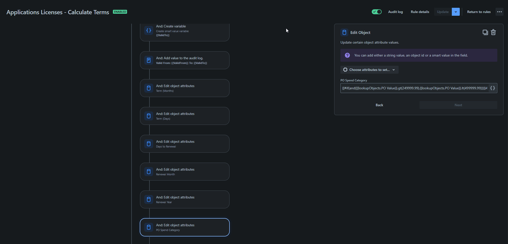

Here is the action I'm using. The goal is to set the PO Spend Category attribute to 499 - 250 if the PO Value is between 499999.99 and 249999.99
{{#if(and({{lookupObjects.PO Value}}.gt(249999.99),{{lookupObjects.PO Value}}.lt(499999.99)))}}
499 - 250
I'm getting a "Parameters not closed" error, but from what I can see everything is closed properly.

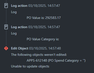

Sorry, I still seem to be running into issues. The edit object was failing, so I've tried outputting the results of the query you provided to the log shown below. It doesn't return anything even when a PO Value matches the logic. Any idea what I'm missing?
Would you please show the current, complete rule and of the complete audit log details for the rule execution?
And...inline math expressions require the values to be numbers. I wonder if lookupObjects.PO Value is returning a list of values and / or it is a text value. The way to check the second one is to add asNumber conversion before the gt: and lt() tests:
{{#if(and(lookupObjects.PO Value.asNumber.gt(249999.99),lookupObjects.PO Value.asNumber.lt(499999.99)))}}
