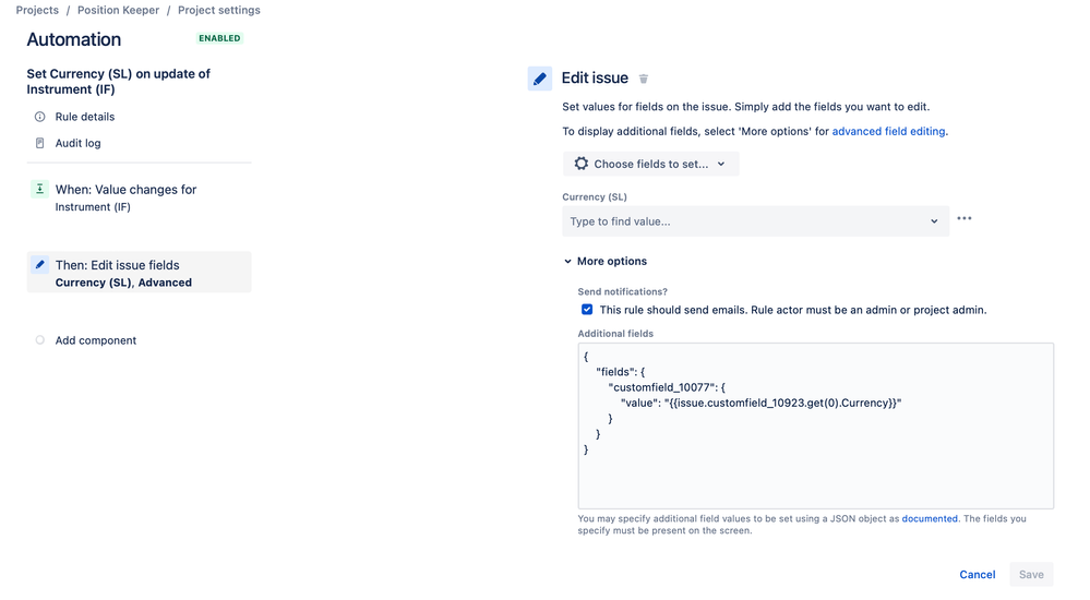

"fields": {
"customfield_10077": {
"value": "{{issue.customfield_10923.get(0).Currency}}"
This works
"fields": {
"value": "EGP"
But the value obviously needs to populate based on what the Asset Currency Attribute value is

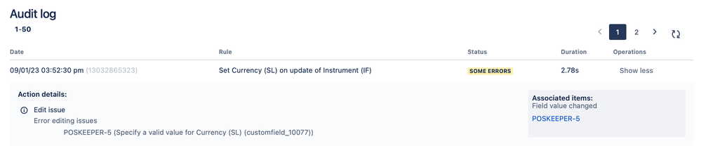

What does the issue.customfield_10923.get(0).Currency return? Can you place it in the audit log?
Hello @Alex Koxaras -Relational-
O my goodness, thank you. it was returning the ID, so added .Name at the end and it is working!

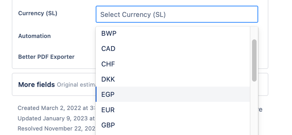

The values are all already options in the Select list.
The Select List options are all currencies e.g.
Below is how the Instrument (IF) data is structured in Assets and displayed in the ticket. I am basically just trying to replicate the Currency Attribute in a field to use for something else. I can manually select the EGP option from the list or add it in the automation, but not get the value from this attribute to auto populate the select list.

This is how the rule looks like
Audit log:
@Ste Wright sorry found the error, needed to add .Name after currency attribute as Currency is also an object type
