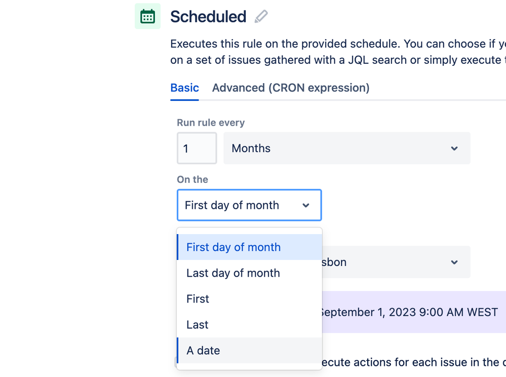

Quick question about a Automation Trigger via Schedule,
Not sure when we select the "On the" "A date" we should expect a date picker?
As i have a target to Run an automation in every 3 months (ignore the 1 month in the picture), but starting only on October 1st.
Try a CRON expression (like shown below):
Thanks for the tip Laurie,
i think this one made the trick

Even though you have an answer using a CRON expression, I recommend submitting a defect to Atlassian Support for what you have found. As the site admin on a paid, Jira license you can do that here: https://support.atlassian.com/contact/#/
I see the same thing and that value "A date" is not selectable...even though it seems to indicate picking a specific date is possible. I was unable to find this symptom in the public backlog for automation rules.
