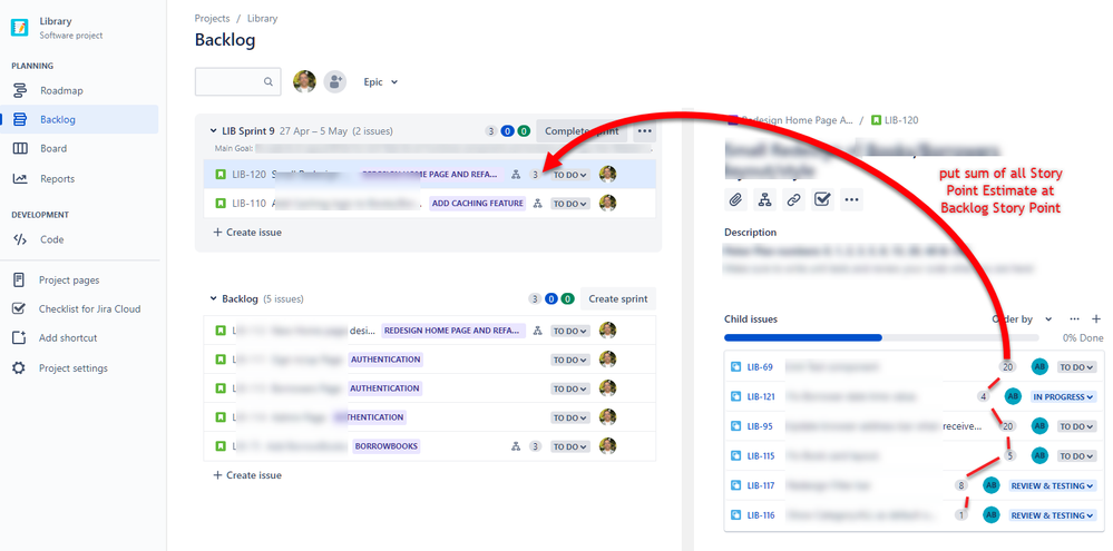

Story:
I want to write an Automation that when one of the subtask STory Point Estimate changed, the sum of all of them add to their parent (backlog) story point. Exactly like the following picture:
But I get this error message over and over:

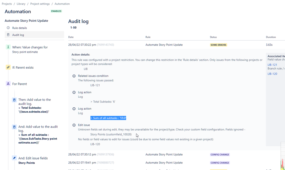

My Script:
My Automation script and its Audit log:
{{issue.SubTasks.Story point estimate.sum}}
What did I do:

Hi @Reza -- Welcome to the Atlassian Community!
Ignoring for a moment assigning story points to subtasks...
You appear to be using a Team-managed project, which uses the Story point estimate field, yet your rule action for editing the parent is trying to set Story points. The Story points field is used for Company-managed projects.
I recall that the Story point estimate field is not currently listed for the edit action's dropdown of fields, so instead you will need to use an advanced edit with JSON: https://support.atlassian.com/cloud-automation/docs/advanced-field-editing-using-json/

Please try this for your JSON, assuming the branch is on the parent issue:
"fields": {
"Story point estimate": {{issue.subtasks.Story point estimate.sum|0}}
Also please note that smart values are case and spacing sensitive, and the rule editor shows almost no errors when we enter these incorrectly. Instead it just treats them as null.
