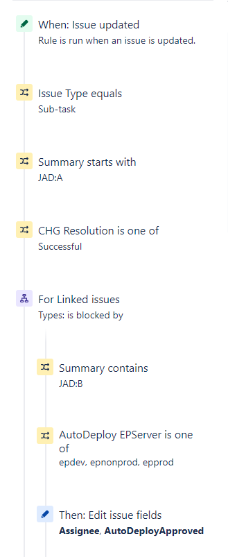

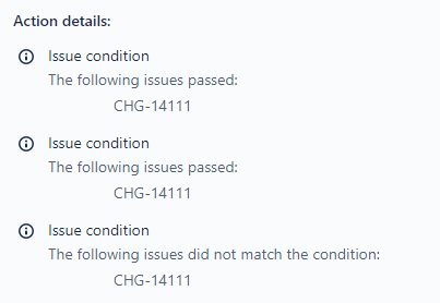

Hello. I am trying to create automation between subtasks but the different rules I have tried have not worked. What I am trying to accomplish is... when subtask "A" is done with a CHG resolution of "Successful" then in subtask "B" the field of AutoDeployApproved is filled with "Approved" and so on to the next subtask. Below is the automation rule that I think should have worked but didn't. I am also pasting the audit log. Please help me with understanding where I am going wrong. Thanks.

Hi @Jesse Ortega Jr
It looks like from your audit log that it's failing when it reaches the condition...
  • CHG Resolution is one of Successful
...is that correct?
If yes, I'd check these things first...
  • CHG-14111 has got the right CHG Resolution (i.e retest it)
  • Change the condition for this line item to equals - making it an absolute
  • I'd also recommend not using Summary contains or Summary starts with - I find these can be a little fluffy, and if the information is repeatable, having it in a select list custom field is more absolute for automation

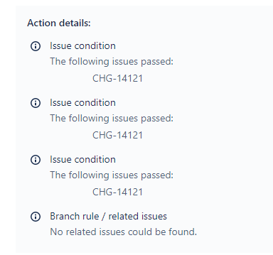

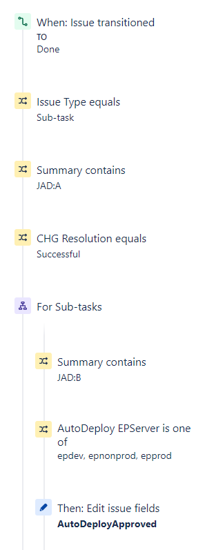

A modification has been made to the Sub-task screen and now automation is picking up the CHG Resolution of "Successful". However, now I have run into the issue that the next sub-task "JAD:B" cannot be found. Below is the workflow I am using and the audit log.

Hi @Jesse Ortega Jr
The branch above is the issue - For Sub-tasks is looking for Sub-tasks of the trigger issue, which there isn't any, as it's a sibling rather than a parent.
It looks like the original branch was For Linked Issues - is blocked by which would be preferable - is there a reason you aren't using this anymore?

Jesse Ortega Jr
March 24, 2022
That worked @Ste Wright ! Thanks for all your help!
