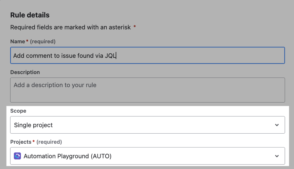

Can you point me to the right side , how to create that multiple-project scope ?
As I mentioned, you need Jira Administrator permissions to be able to do this. If you do, navigate to Global Automation in Jira Administration (can be found at https://<your jira site>.atlassian.net/jira/settings/automation#/rule-list), locate your rule and select Rule Details.
Right there you can select the rule scope and - for multiple projects - select the projects it applies to:
