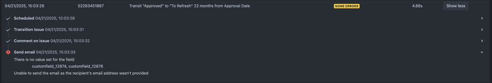

I'm trying to use automation to comment and send emails to all users in both fields when a specific action occurs. The comment portion works, but the sending email failed. My Jira Site Admin has added the two fields at the global level. But the sending of email action still failed after I chose both “Business System Owner” and “Technology System Owner” in the “To:” field in the send email action. The audit log states two types of error:

But it doesn’t work when I used the audit log customfield values:{{#issue.customfield_12874}}[~accountId:{{accountId}}] {{/}}{{#issue.customfield_12876}}[~accountId:{{accountId}}] {{/}}
Attached are the rule set up, the field tab showing duplicate fields and audit logs.

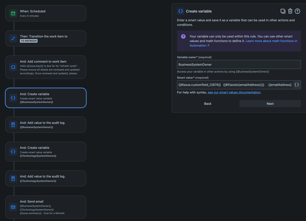

Hey @Akash Singh thanks for the solution. Can I check where should I input the create variable portion in my current rule? Would it be after the "And: Add comment to issue"?
Since there are two custom fields, I just create another one for {{#issue.customfield_11516}}?

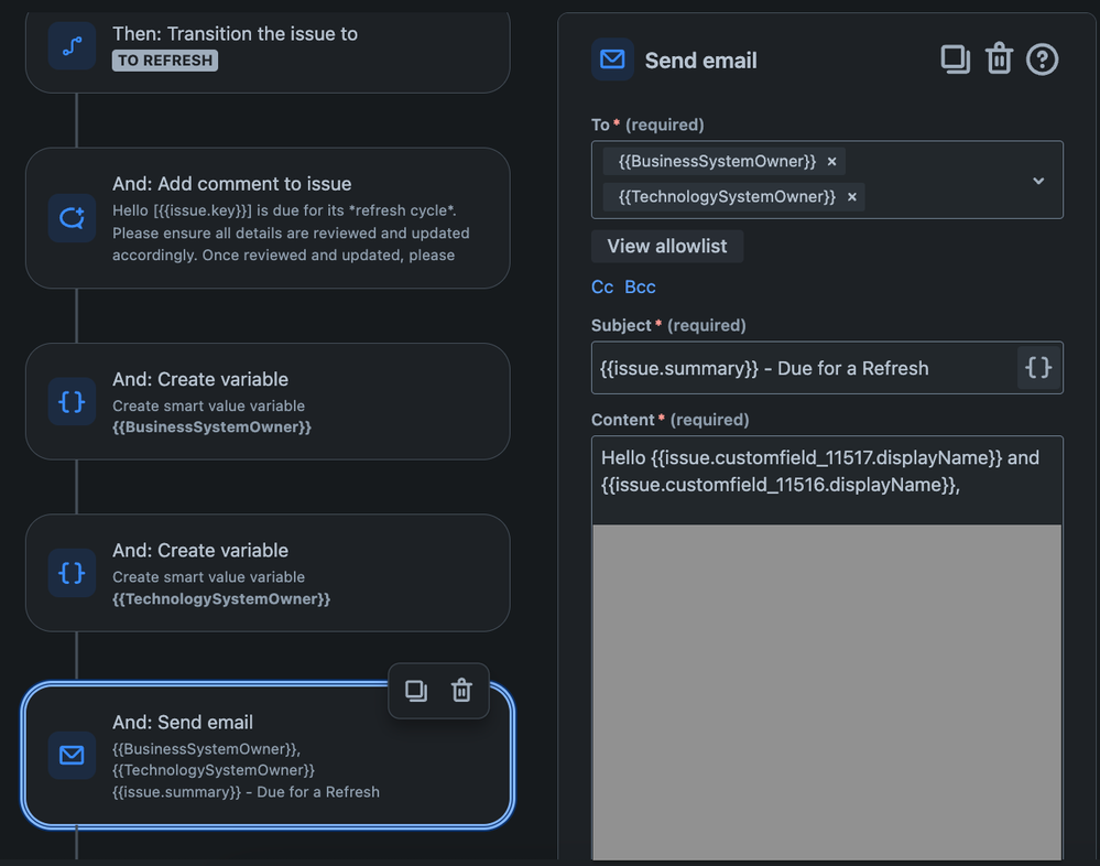

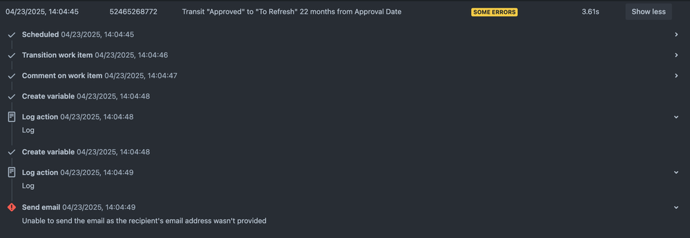

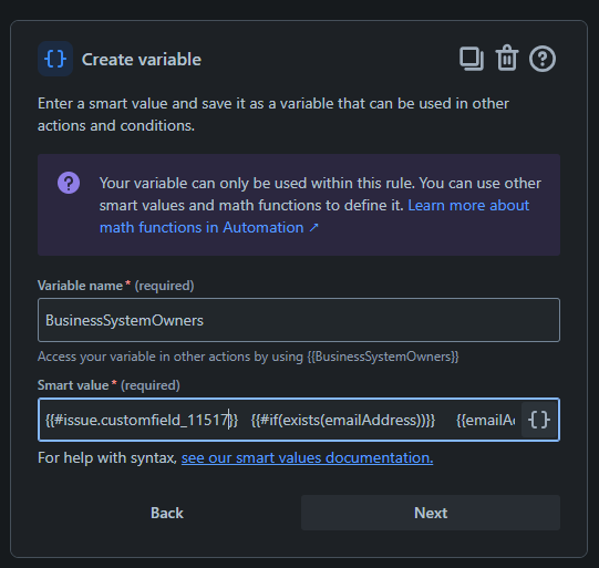

I have set it up like this, but couldn't select the variable option and input it as {{BusinessSystemOwner}} and {{TechnologySystemOwner}}:

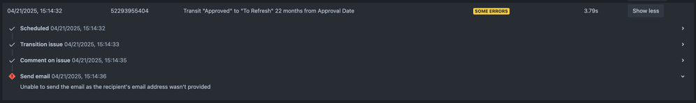

This is the audit log I got when I run it:
Am I on the right track?
Thanks in advance.
@Nur Fatin This seems to be correct, can you add a log action and check the value stored in the variable?

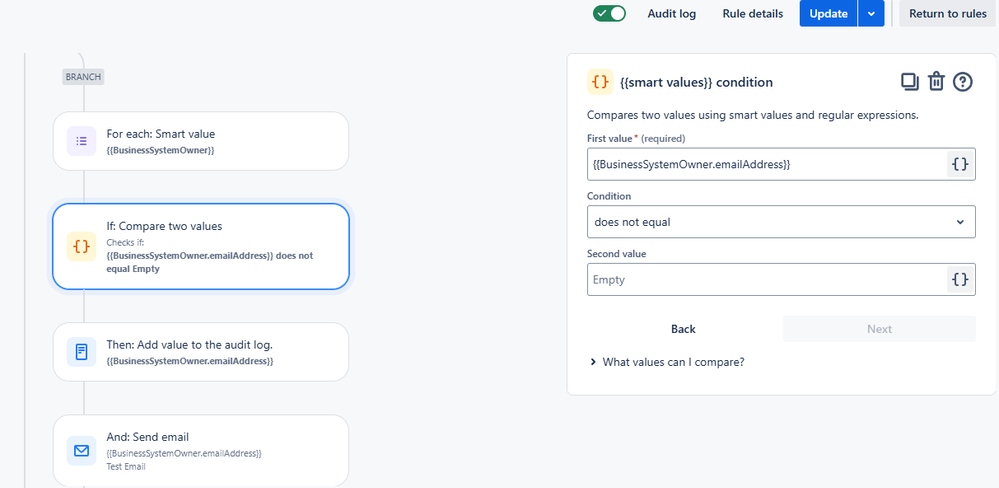

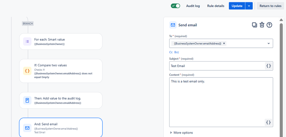

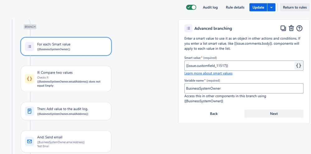

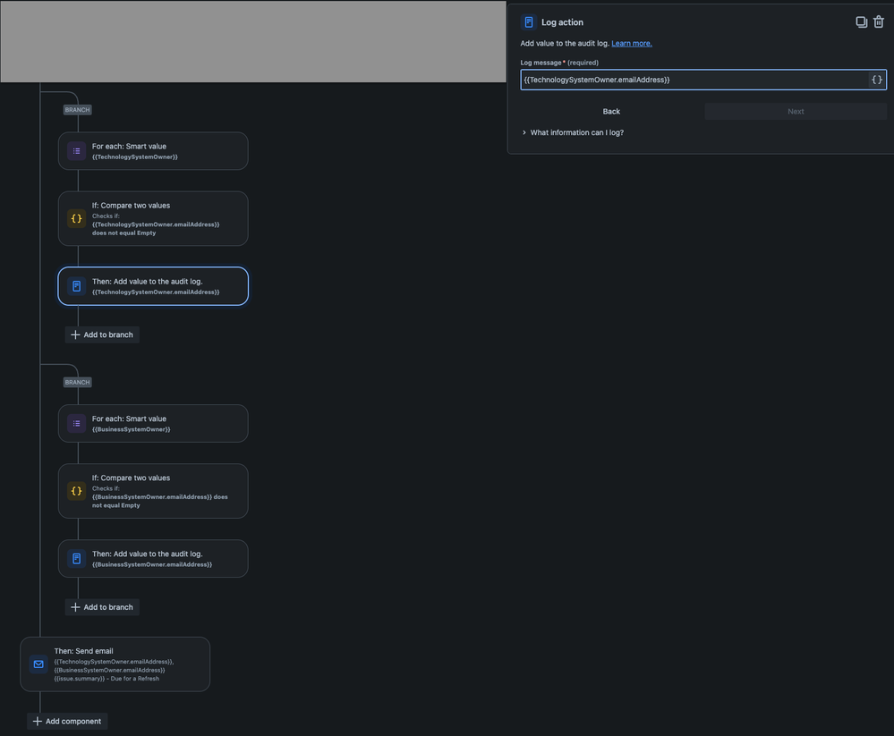

That said, there's still a way to achieve the desired outcome. You can use Advanced Branching to loop through each user in the field, as demonstrated in the screenshot below.
Within the branch, you can add a condition to check if the user's emailAddress exists. If it does, you can proceed to send the email to that user. You'll also need to create separate branches for each of the two fields you're targeting.

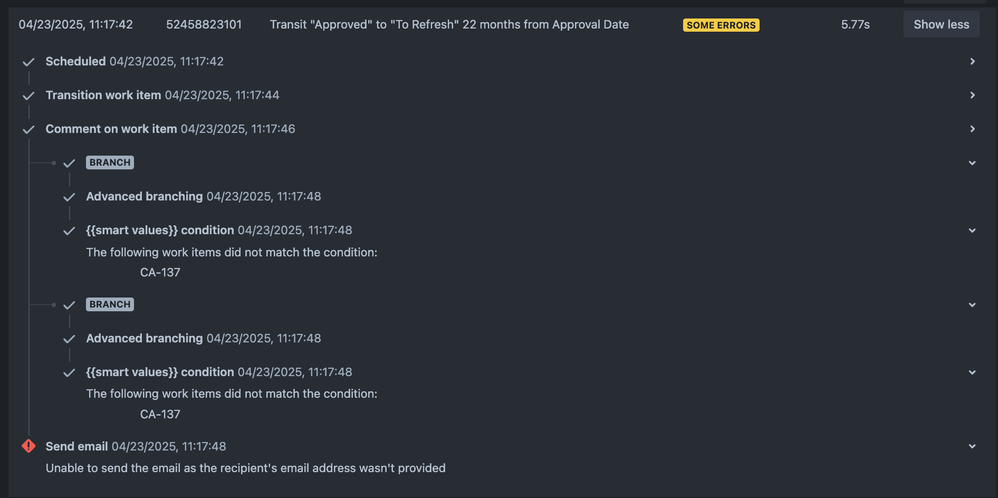

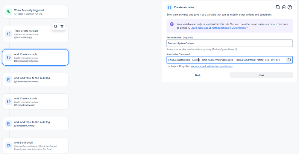

Hey @Akash Singh is it possible to do the branch rule first and then outside of the branch, do the send email action? I wanted to input both fields in the "To:" field in the send email action.

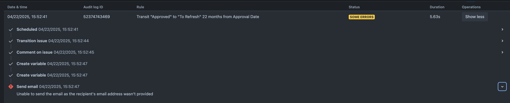

So far I set it up like this and the audit log is shown below:
After reading through @Bill Sheboy’s response, I realized that simply replacing the semicolon with a comma in my original post should allow your automation to work without requiring branching.
Additionally, I noticed that we had been using the wrong custom field ID for those fields. With the correct IDs, the smart values to access each field’s email addresses would look like this:
For Business System Owner,
{{#if(exists(emailAddress))}}
{{emailAddress}}{{^last}}, {{/}}
For Technical System Owner,
You can then simply use both the variables in the Send email action and as long as one of the field has at least one recipient the automation should work.

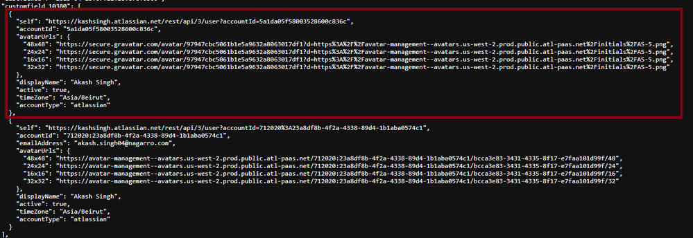

To confirm the second scenario, you can inspect the issue’s JSON response directly using the following Jira REST API endpoint. Be sure to replace your Jira site URL and the issue ID before making the request:
https://your-jira-site.atlassian.net/rest/api/3/issue/<ISSUEDID>
Check the values for customfield_12874 and customfield_12876, and look for the presence of the emailAddress attribute in the user objects.
This behavior aligns with a known feature suggestion requesting that the emailAddress attribute be included in the People field object implementation.
I was able to reproduce the issue in my instance as well, see below screenshot. Here my first account doesn't have email present but the second one does.
At this stage, if data migration isn't a significant concern, I’d recommend creating two new site-wide multi-user picker fields and using them directly in the automation rule. This approach is more reliable than depending on the People field in team-managed projects, as the emailAddress attribute in the user object can be inconsistent.
@Akash Singh I have inspected the issue's JSON response and received the same results as your screenshot. Both customfield_11517 and customfield_11516, I can see an email address. I noted that the customfield_12874 and customfield_12876 were the incorrect ones.
When I tried the same automation set up, create variable with the correct customfields, it is the same audit log of "Unable to send the email as the recipient's email address wasn't provided." as before. In this case, the other option is to get my Jira Site Admin to add user picker field at a global level?
