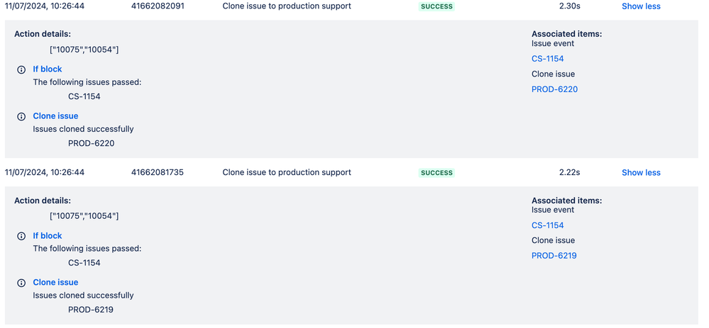

Alex Dokhtiar November 8, 2024
Hi @Bill Sheboy , thank you for the reply.
I don't have two separate rules, by some reason trigger happens twice within this automation.
Here is an image of the audit log within the ruleScreenshot 2024-11-08 at 11.13.29.png
It appears that, for some reason, the rule is being triggered not only on transition but also on creation, which shouldn’t be happening and I don't know how to avoid this from happening.

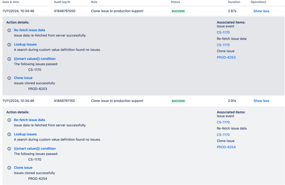

Alex Dokhtiar November 11, 2024
Hi @Bill Sheboy ,
Unfortunately, it still doesn't work as expected and duplicates are created.
Looks like there is no workaround. Anyway, thank you for the help!
