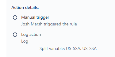

Josh Marsh September 21, 2023
This is a great suggestion but it isn't working for me :( anyone know what I'm doing wrong?
customfield_12737 is a multi-select Assets field.image.pngimage.pngimage.png

Benjamin Črnjak
January 31, 2025
EDIT: I just find solution to my problem:
I was using .split(",") before and couldn't solve my problem.
Now I've tried with .split(", ") --> one blankspace after comma.
I suggest making a log-print of a text that you want to split, one step before splitting it. Then make sure there is ", " (comma with one blank space) between each of your values you want to split.
Now, use .split(", ").distinct against your variable, and you should get values as a list and without duplicates.
Hope this helps someone.
