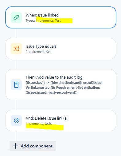

  • screenshot of Automation rule: Rule.jpg

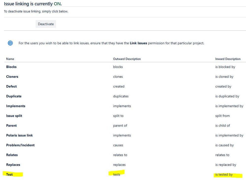

  • screenshot of linking type definitions in our Jira installation: LinkingTypes.jpg

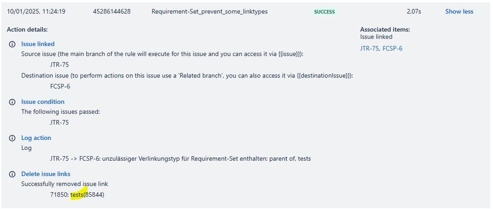

  • screenshot of successful audit log (fired on adding a link of type 'tests'): AuditLog.jpg
  • content of action audit log: {{issue.key}} -> {{destinationIssue}}: unzulässiger Verlinkungstyp für Requirement-Set enthalten: {{issue.issueLinks.type.outward}}
  • I expect the rule to trigger on 'is tested by', not only on 'tests'.

The log shows the Jira issues linked are in two different projects.  What is the scope of the rule noted in the details at the top: single-project, multiple-project, or global?
Scope is important for such rules as links have "direction" and so when an issue is linked from one project's issue to another, the rule may not trigger based on the direction.  The way to solve that is:

But, playing around again brought me to the idea, to test against the destination issue type, which is story. And see, the automation fired!!
So if I'll have some free space I will think about a more enhanced rule definition, checking for the issue types on both sides of the linking.
