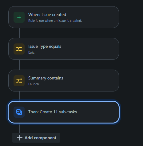

Simplified, is there a way to combine the "Create a New Story" step with the "Create sub-tasks" action? I would like to have my Sub-tasks actually be Stories, not sub-tasks, under the Epic when Summary contains a key word.
This is what I have so far:
Has anyone found a way to make this happen? Or at least define what you want your news stories to be if taking the route from the link above? Thanks.

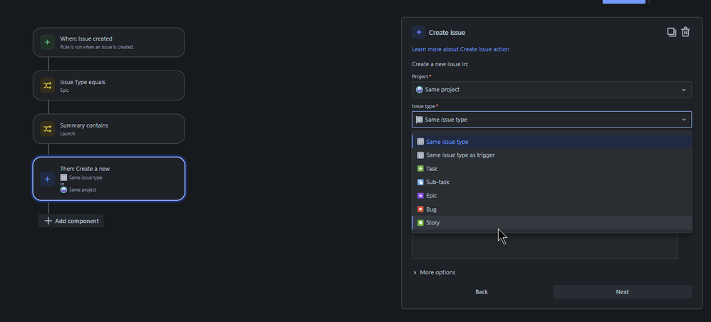

So you would start off your rule creation the same way you have but then you will create an issue type and select story, you will have to do it 11 times.

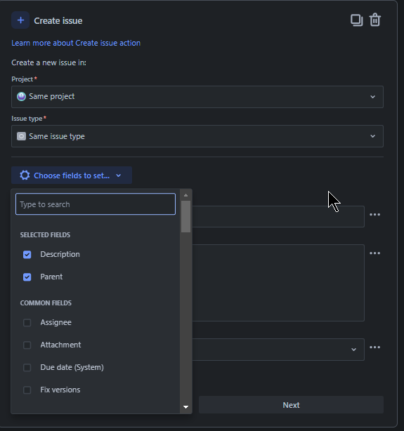

Then to tie it back to your epic you will need to make sure for each story to add the parent field as a field to set under the drop down. If you don't do this you will just create stories that are not connected to your epic.

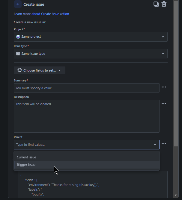

Once you have added that field to each story you are creating you will need to make sure the parent is assigned as the trigger issue that started your automation rule off.
