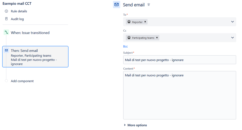

Hello @John Funk ,
thanks for the tip, however it does not work with smart value.
I've been playing around, and accidentally discovered that group picker fields are recognized if you write the full name, the same way you add groups:
We can work with automation for mail notification.
Thanks John, your tip guided me the toward the solution!
