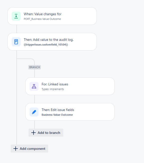

I have create the automation rule as follows (from value change in JSP to edit related field in it's linked issues (e.g., in JDP):
I have also typed in the box below Business Value Outcome: {{triggerIssue.customfield_10504}}

Finally, issue linking is often directional, especially for JPD <-> JSP (Jira Software Project). But your branch is checking link types which are in both JPD and JSP issues.
If you want the branch to select the JPD idea for the JSP trigger issue, please change the branch to only check "implements".

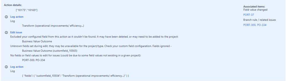

Still no luck as per screenshots (updated rule and audit log outcome after retrying):

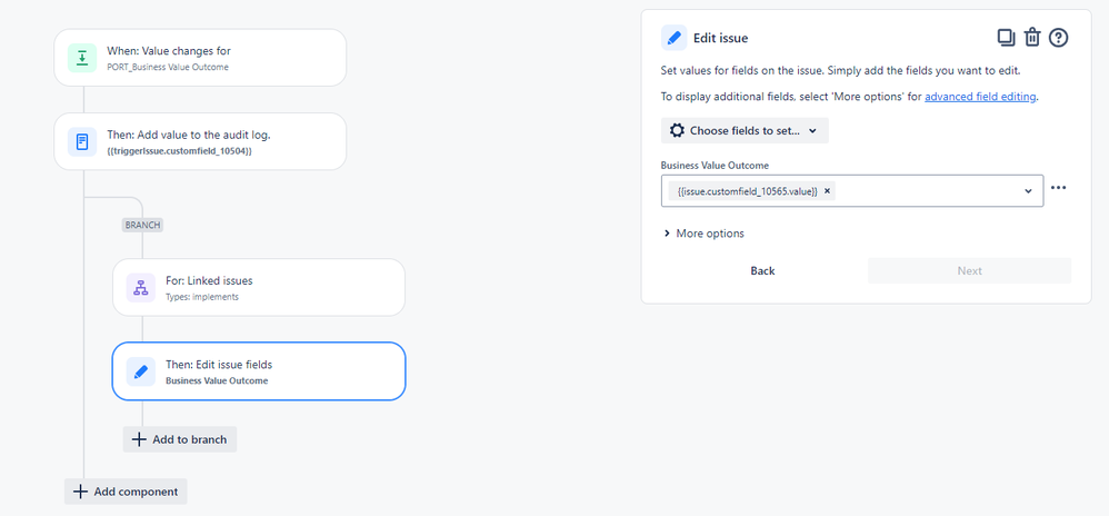

EDIT section updated as follows:

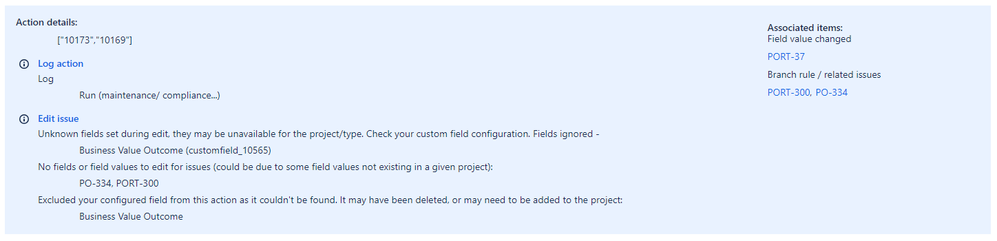

and audit log is same as others:

It appears someone linked together two JPD ideas with the "implements" link type: PORT-37 and PORT-300.
Thus PORT-300 is also found by the branch, and JPD ideas do not have the JSP field, Business Value Outcome, leading to the rule error.

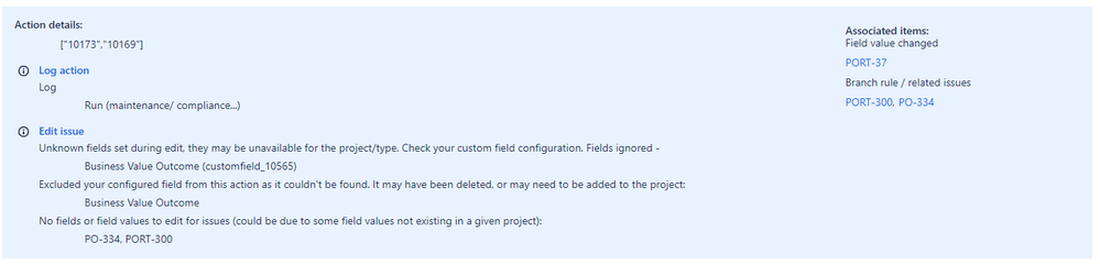

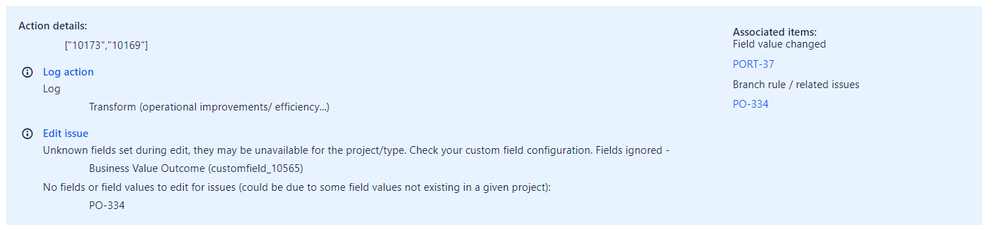

hmm -> ok, still not luck... I removed linked issue PORT-300 and I get the following error log:

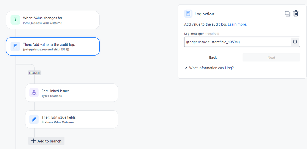

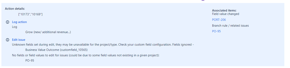

I tried on another JSP issue... changed PORT_Business Value Outcome (10504)... and the linked issue (relates to) to change JDP field: Business Value Outcome (10565) -> same error log:
This is how my rule is configured:
WHEN
THEN
BRANCH
Honestly - thanks for looking in to this - just very confused why it's not working... it seems in the Audit log that on the impacted issue (one where the value is to be edited) is doesn't recognise customfied_10565

Why did you change the branch on linking from "implements" to "relates to"?

I removed "implements" and changed to "relates to" -> because the issue to be 'edited' was a linked issue by "relates to" connection.
I didn't realise I had that branch config wrong... when I had PORT-300 linked that was by "implements".

Short version: it appears your scenario has uncovered an apparent defect in automation rules with JPD idea / issue edits and multiple-project scope rules. There are known limitations with JPD and automation rules, but this one is not listed.
I recommend working with your Jira Site Admin to submit a defect here to learn what they suggest: https://support.atlassian.com/contact/#/ I recommend including a link to this community question so the support team can observe what was tried. When you hear back from them on a solution, please post what you learn to benefit the community. Thanks!
I do see an error in the last images you posted, where the edit issue action uses the incorrect custom field id, but that does not impact the apparent defect.
