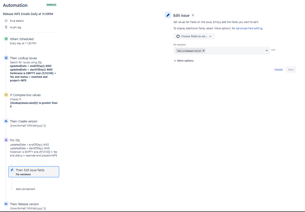

Hey I have a automated job that runs every night at 11:30 PM that basically checks in the project if any tickets were marked as resolved for that day and if so it creates a version, edits the fix version for those tickets and then releases the version.
This works great if only 1 ticket was released but if 2 or more are released the release is empty
here is the rule:
The JQL selection is the same in both cases
so what I would expect is that the for each loop would suspend the automation until its done looping through
can anyone provide me some help?

Hi @Kevin McGillicuddy
Too long; didn't read: this is a timing problem, which is solvable.
Branches which can occur on one-and-only-one issue (e.g. branch on parent) get run "in-line" and so the rule proceeds after the branch.  But...all other branches execute in parallel and asynchronously: there is no guarantee they will even finish before all other actions in the rule.
So for a work-around you need to capture the Created Version information so it is not released before you try to reference it as the "next unreleased version".
A few ways to try that are:
  • Complicated, slow, and will always work: REST API
    • call the REST API to get the version you just created, and
    • use that value in the branch to edit the issues
  • Simple, and will always work: dummy issue
    • create a dummy issue in the rule,
    • branch to Most Recently Created Issue to assign the next unreleased version,
    • save the {{createdIssue.fixVersion}} in a created variable
    • reference the created variable in your original branch to set the version, and
    • then delete the dummy issue at the end of the rule
  • Simple, and will probably work: update one and reuse
    • similar to the dummy issue technique, branch to the first issue found in the lookup and edit that one, exit that branch and re-branch to it again, and then grab the version to save in a created variable
    • then in your original branch there will be one fewer issue to process, and you can use the created variable for the update
    • Please note: this may also run into a timing problem if the second branch starts before the first one finishes.  Yikes!

hey @Bill Sheboy  - this is super good info, it got me going down another path and based on my maybe flawed test, works for far
The run order is still out of sorts but when I went to releases I saw them all in there - so will try it out maybe with live tickets and see what happens. I may have to come back to your drawing board if it does not work

Interesting...what are you setting that created variable to as no issues have the newly created version yet?
Kevin McGillicuddy
July 18, 2022
So because, and this is somewhat hacky, I am using a standard for versions which is a date without a timestamp - so 07/08/2022 - so I can easily re-use this format for the variable value. People or organizations that would need more dynamic releases this would obviously not work. The automated rule will only ever run once a day so no collision issues
We mainly use releases/versions for communication sake - so all the issues that went live during that day get wrapped up  into 1 version for that day and we have another add-on that sends out and email summarizing changes for that day
