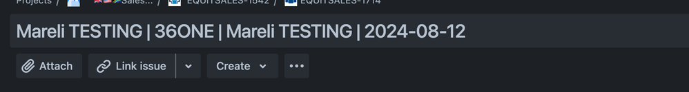

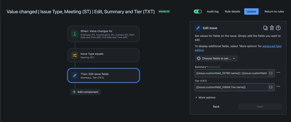

I created this automation to update the summary when a field value changes:
I have managed to get the date format the way I want it but I am struggling to set the correct time in the summary.
In the Automation the date field referees to customfield_12025 which is the "Start Date ann Time (DP)" field:

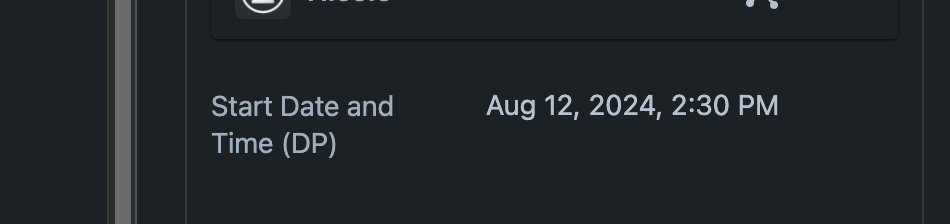

As you can see the time is set to 2:30 PM.

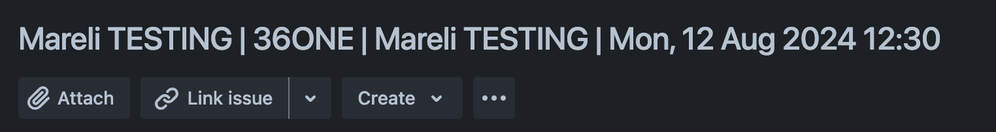

But when I trigger the Automation the wrong time comes up, the time reads 12:30 instead of 14:30 or 2:30 PM:

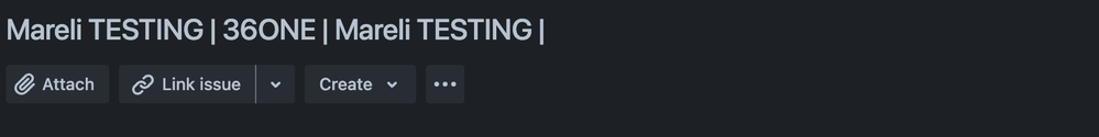

I've tried the following to get the correct time:
None of these seem to work they just leave out the date and time completely, like this:

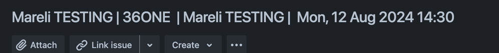

IT WORKED!
Thanks so much:
I used this one:
{{issue.customfield_12025.convertToTimeZone("UTC+02:00").format("EEE, dd MMM yyyy HH:mm")}}
