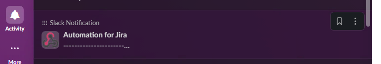

The audit log has a success record but my engineers did not receive a slack notification. What is interesting is that I received a slack notification but I assume I received it as the owner of the slack bot?

I tested using the Send Slack Message action to send a message to my own Slack account, with a webhook I had already confirmed worked successfully to send a message to a channel in the same Slack workspace. I found that the message appeared under my conversation with "Slack Bot" rather than in my direct DM. I found the message by clicking on the Activity button in Slack.
