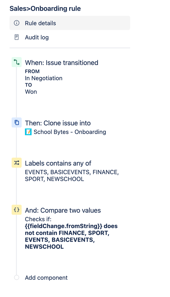

I am having an issue with a new field tab I have set up. Basically, I have one Jira board that copies to another (sales-onboarding). I created a new mandatory field in the sales board which is not causing any issues in the automation audit log. When it gets copied from one board to the next (once it is completed) I have 'Issue condition' passed and then 'create issue' 'error creating issue' 'custom field is required' and then 'create issue' 'error creating issue' 'custom field is required'. I am still a rookie at this and learning. In the original sales board when the issue is cloned I have the 'custom field' 'copied from current issue'. Any advice would be great. Thanks in advance.

This is an example of the automation error I get in the onboarding board once the issue has been cloned over.

For that error message: cloning issue links is not supported yet for an automation rule. Here is the suggestion to add that: https://codebarrel.atlassian.net/browse/AUT-2133
I believe the work-around is to clone the issue, and then use a branch on created issue to add them...although when you clone into a different project that means the rule must be defined as global/multi-project in scope.
Also I noted...you referenced the smart value {{fieldChange.fromString}} and with a transition trigger I expect that will only contain Status information...unless you have a transition page/screen in your workflow. What I do not know: does the transition occur (and so fire the rule) before or after that page/screen is completed. Perhaps write {{fieldChange}} to the audit log to confirm. If in fact it is after the page/screen then {{fieldChange}} is a list of changed fields and not just one.
