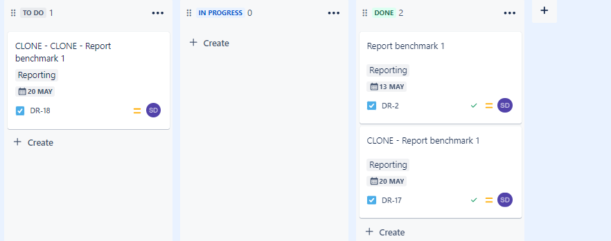

I have tasks that need to repeat weekly and monthly. I can clone a task when moved to DONE using the trigger. I need to be able to add the future date to the clone each time the clone task moves to DONE and the new one is added to TO DO I would like the new date to keep adding the week from the previous task not the first, tried using {{now.plusBusinessDays(14)}} for 14 days and this works on first task but the second task cloned is same as if taking Due Date from master task and not the 1st clone.

No using above. So I added screenshots and the 7 days is being added to the first clone but not the second. Its taking same date from main task still and adding the 7 and not from the 20th on the clone making the new clone 7 days later. Also, task name keeps appending CLONE to the new CLONES how do I stop that...thanks

Hello, I am using the first screenshot trigger, the output above is the result of that trigger.
This works by remove the CLONE at start of summary, would be good if I can add an appending 2 for clone 2, 3 for clone 3...and so on? Also I think the trigger applies to all tasks, if I wanted different Due Dates would I use the add a branch.
There's not an easy way I know of to increment the number. I would personally do something like add a date in the subject of the ticket (like "Task X - week of May 9 2024")
Yes, you could add branches to set different actions. Like: IF task priority = high, clone with due date X; IF task priority = medium, clone with due date Y; ELSE clone with due date Z
