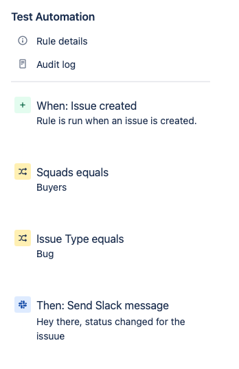

What I did:
This does not seem to work.

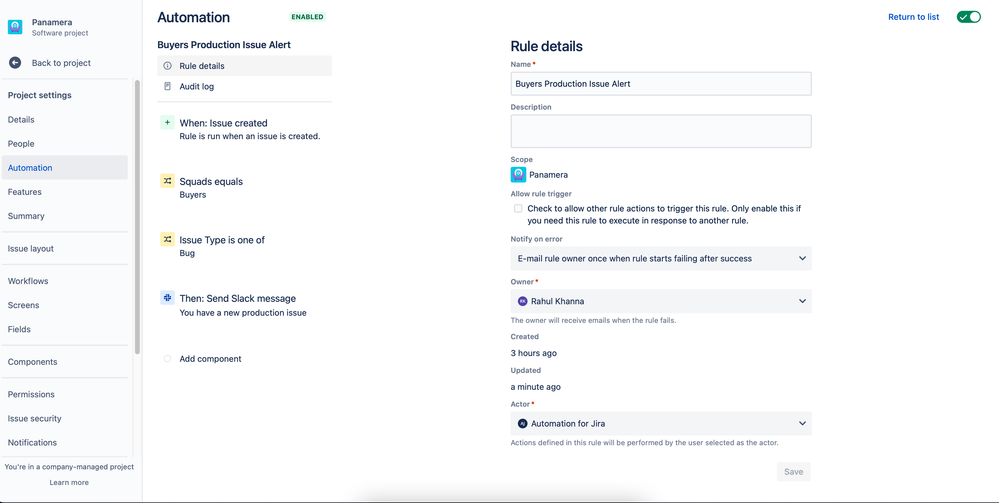

On your points, the rule is created in project settings. Please check below screenshot:

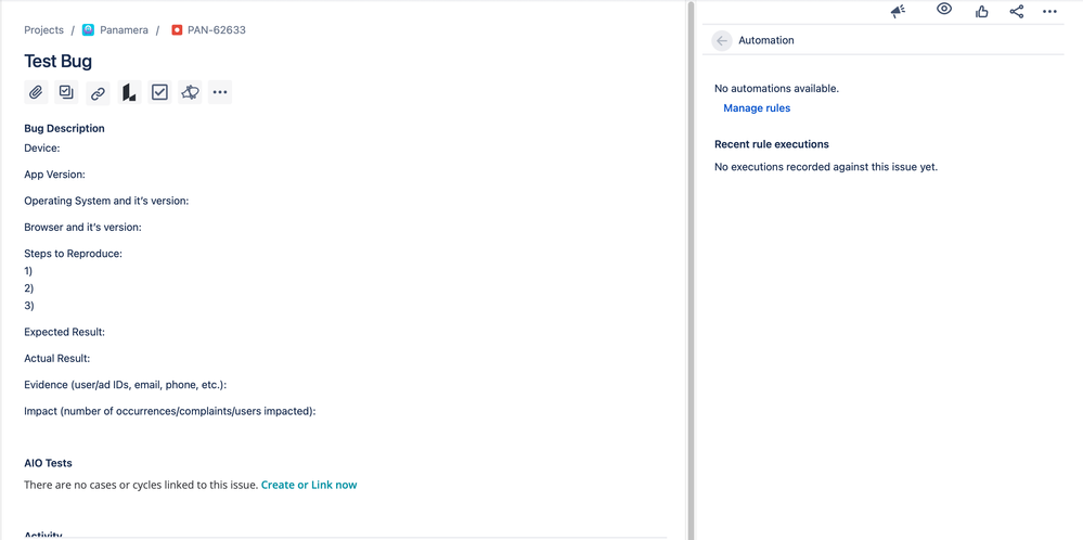

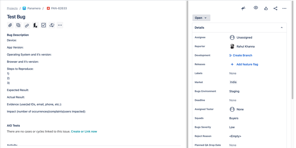

I then created another "Bug". You can see the project and squad in the screenshot below. Please notice the jira id.
I tried troubleshooting and found that no automation rule has been applied.

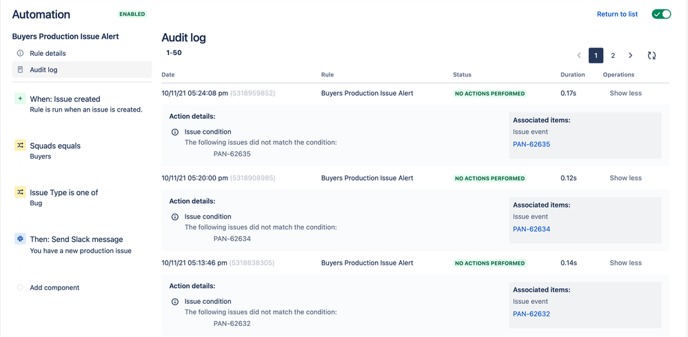

The audit log clearly show that the above created issue simply skipped the log queue. Check screenshot below:
