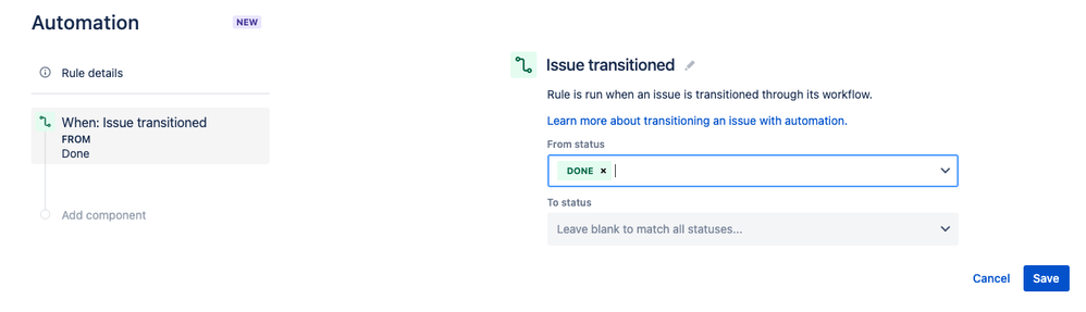

For the Automation solution, you're making it too complicated. It is much simpler than that. Let's start with your Trigger. It should specify that the transition is From the "done" statuses (whatever those are for your project. That will stop the rule from being triggered on every status transition.

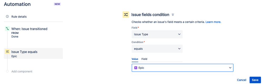

Next you need to check if the transition was for an Epic type of issue.

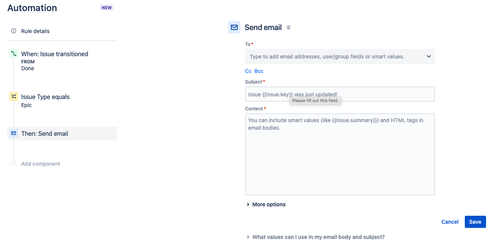

Then add a Send Mail action (or other type of notification action if you wish) to send your chosen people an email.
