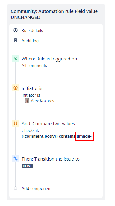

Imo the automation would occur if the fields had changed and not the opposite. In your case and since the fields are not changed, then I would simply transition the issue manually.
However if you really really really really really want to transition the issue when you paste images without changing the fields then you could do the following rule:
Searching for the comment containing the string !image- is equivalent of searching for an image within a comment. The response of an issue as JSON returns the following:
I've tested it and it works if I paste just a single image. This rule will run even if you paste a image and write some stuff. Meaning you have to be very careful with it.
Imo, I wouldn't use it and I would stick to manually transition the issue, OR find another business requirement with which I could automate the procedure.
