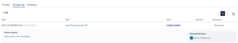

Herve Wiederkehr November 4, 2022
Here is the screenshot after editing then executing (nothing happens) but no trace in the logAudit Log.jpg

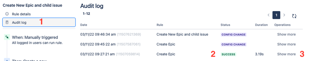

Can you also share the Audit Log for an execution of the rule?
1. Click on Audit Log above the rule components.
2. Find an execution that says "Success" in the Status column.
3. Click on "Show more" to the right of that.
4. Provide a screen image of all the messages revealed.

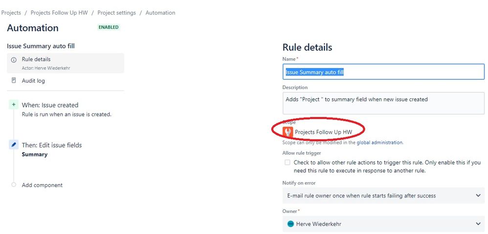

In the Rule Details, what is specified for Scope? This should list the project(s) against which the rule will run. The rule is triggered by creation of an issue in the specified project(s). Has an issue been created in the specified project?
Herve Wiederkehr November 5, 2022
Thank you for your answer.
The scope for this automation is the project "Project Follow Up HW" (See screenshot attached).
As the even isn't fired as was wondering if it could be related to my browser config (Chrome) related to javascript or even my antivirus?
Kind Regards

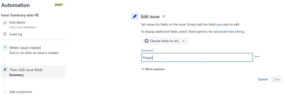

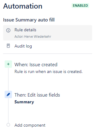

Thank you for your prompt reply.
Please find the screenshot of the role hereafter.
Kind Regards
Hervé
