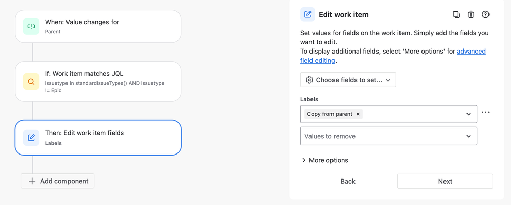

Hi guys,
How I can build an automation rule for this case: When an Epic is linked to a Story/Task/Bug, copy the Epic’s labels to the issue, adding (not replacing) them?

While I haven't tested it entirely through, wouldn't this work?
It's a quick draft, but I'm sure you can optimise. I chose the option to add/remove labels on the right hand side.
Hope this helps!

Hi @Walter Buggenhout
Thanks for the reply! I've tried it, but it didn't work. It shows config change but when I see the linked issues, the labels are not copied..

Nikola Perisic
July 28, 2025
It did work when the Parent field was changed, but can this be adjusted when you link an epic to story/task/bug, the epics' labels are copied to these issues?

Nikola Perisic
July 28, 2025
@Walter Buggenhout I figured it out in the end, thanks!

Walter Buggenhout
July 28, 2025
Ah, ok ... I was just going to get back to you as I tested it and it seemed to work flawlessly in my test site.
I understand from your previous comment that it was a trigger issue / reference to the epic as a linked work item rather than a parent. Correct?
