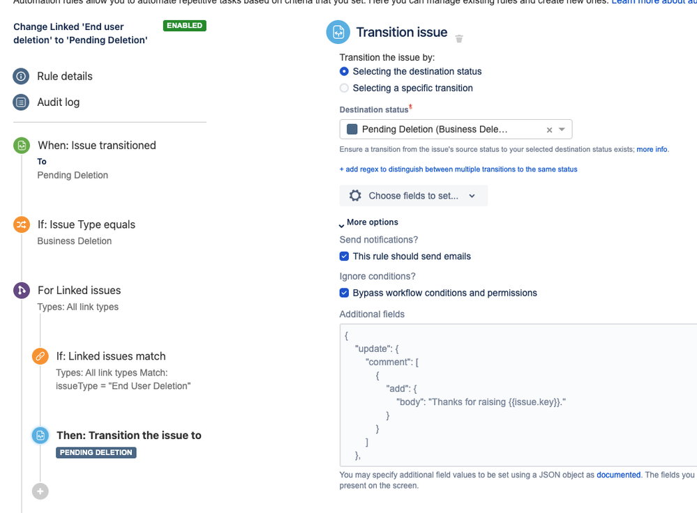

I want to create an automated rule for a status transition of linked issues.
This issue type has restriction for this transitions (should move from new -> 1st approval -> 2nd approval -> pending deletion) only 2 users can move the ticket to 1st/2nd approval.
I checked Bypass workflow conditions and permissions

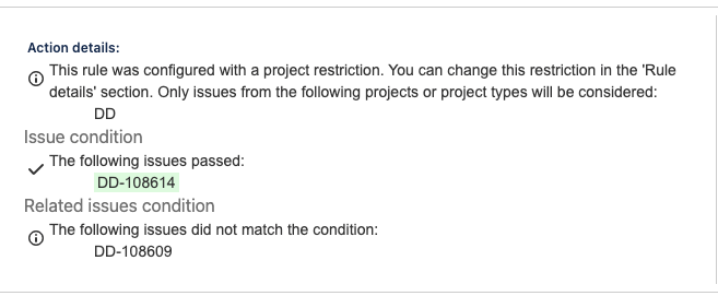

and I am still getting this error in the logs -
NO ACTIONS PERFORMED
This rule was configured with a project restriction. You can change this restriction in the 'Rule details' section.

@Ron can you please paste a screenshot of the rule log?
Ron July 7, 2022
Alex Koxaras -Relational-
July 7, 2022
@Ron you are not getting any error with this rule. The passage you copied/pasted is an informative one, hence the "i" next to it.
Your rule runs smooth. However the linked issues didn't match the conditions you specified. That's why no actions were taken:
All link types must be equal to a certain issue type (end user deletion).
Are they all the same?
Ron July 10, 2022
I need to change all linked issues of type 'End User Deletion'.
Currently I have one linked issue of this type and the condition fails

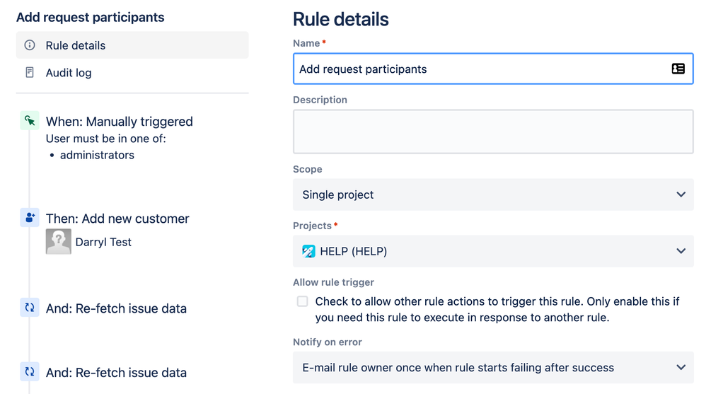

Darryl Lee
July 7, 2022
You can also look in the Rule details section to edit the the scope of your rule:
