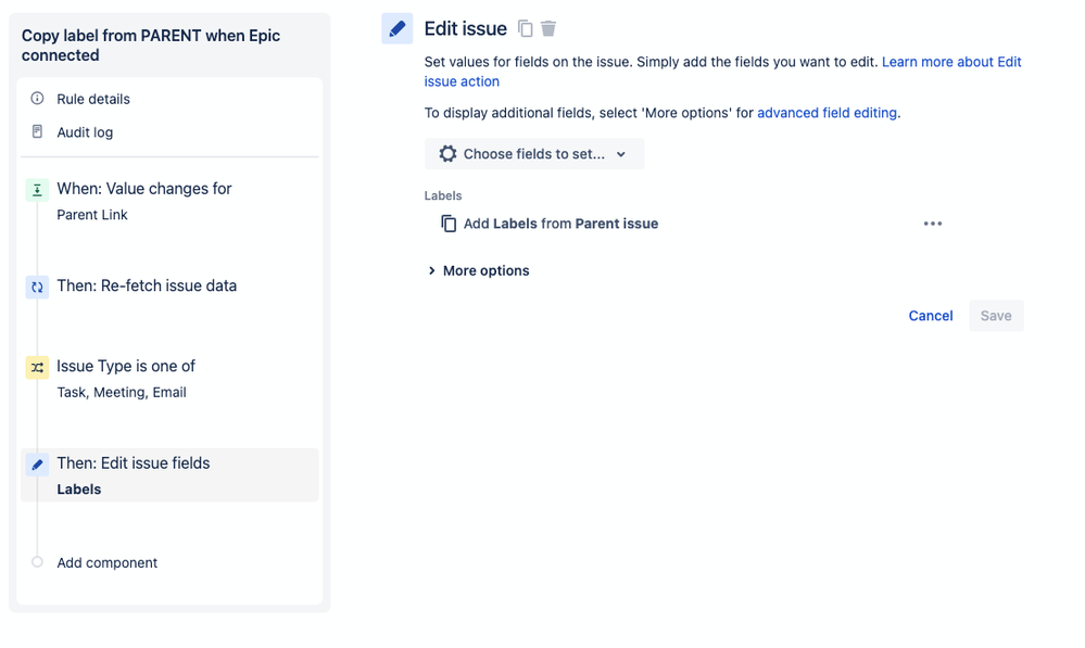

I have an automation that runs if a parent link is added, changed, or removed from an issue.
My main problem :
When I create an issue from an EPIC, it seems, that it both creates and edits the issue. so.. the rule runs twice.
I created separated automations for creating and editing issues, and it confirmed the behaviour..
the rune is rules once for creation and once for edition when creating an issue directly from an Epic.
Also... when I create an issue without linking it from scratch to an Epic, I get an error.
Some help on that would be much appreciated.

I have seen this symptom noted in a few other posts: issue linking does not occur at the time of issue create, and instead happens as a separate edit.  This happens for manual issue creation and by automation rules.
Which is curious as the REST API does support adding one link, but not several.  And so that is probably why this design was used.  There is an open defect / suggestion to allow adding multiple links during issue create: https://jira.atlassian.com/browse/JRACLOUD-81845
So on to work-arounds...
One way to solve this is to remove the Create Issue selection from the trigger.  For your scenario you want to perform the same action for create and edit, and so eliminating the create selection should solve the double rule execution.

Indeed, deactivating the "creation" trigger helps ! I am ashamed I didn't think about it 😅
