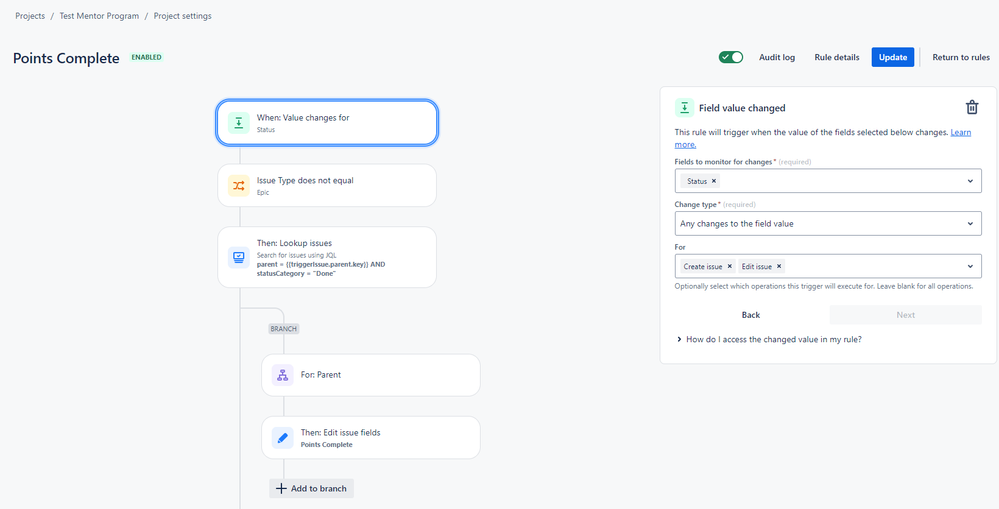

Here's what I have currently -
When: Value changes for Status
Issue Type does not equal Epic
(I also tried a variant where I added in the Condition And: Parent exists)
Then: Lookup issues
parent = {{triggerIssue.parent.key}} AND statusCategory = "Done"
Branch
For: Parent
Then: Edit issue fields
Choose fields to be set = Points Complete
{{lookupIssues.Story Points.sum|0}}
Weird thing is when I look at the audit logs, it doesn't seem like the rule is even being triggered.
Problem solved. In case anyone else runs into this issue as well.
I realized my error was in Step 1 Field Value Changed.
I selected:
Status (correct)
any changes to the field value (correct)
Add issue, Edit issue (wrong! correct value here is Transition issue. Now it works like a charm.
