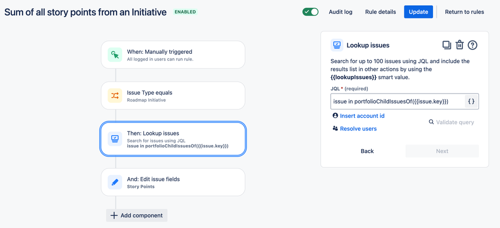

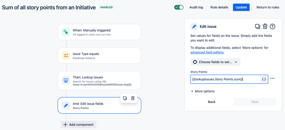

I have created an automation rule the looks up all the child issues of an Epic then totals up ({{lookupIssues.Story Points.sum}}) and stores the result in the Story Point field of said Epic.

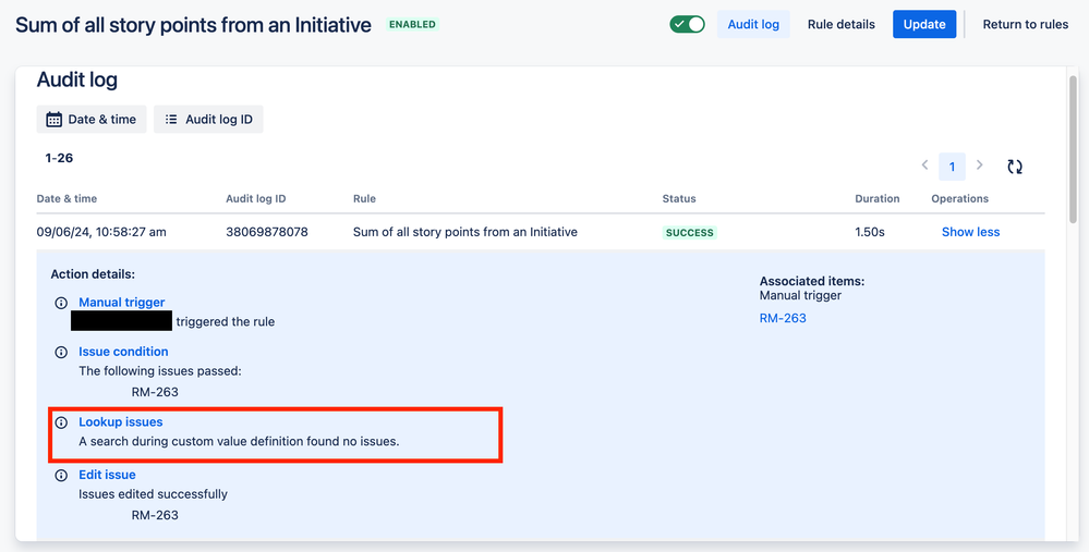

Currently I am trying to do the same for an Initiative with no success. Same rule, same JQL to find child issues. When I check the Audit Log the "Lookup issues" step says "A search during custom value definition found no issues."

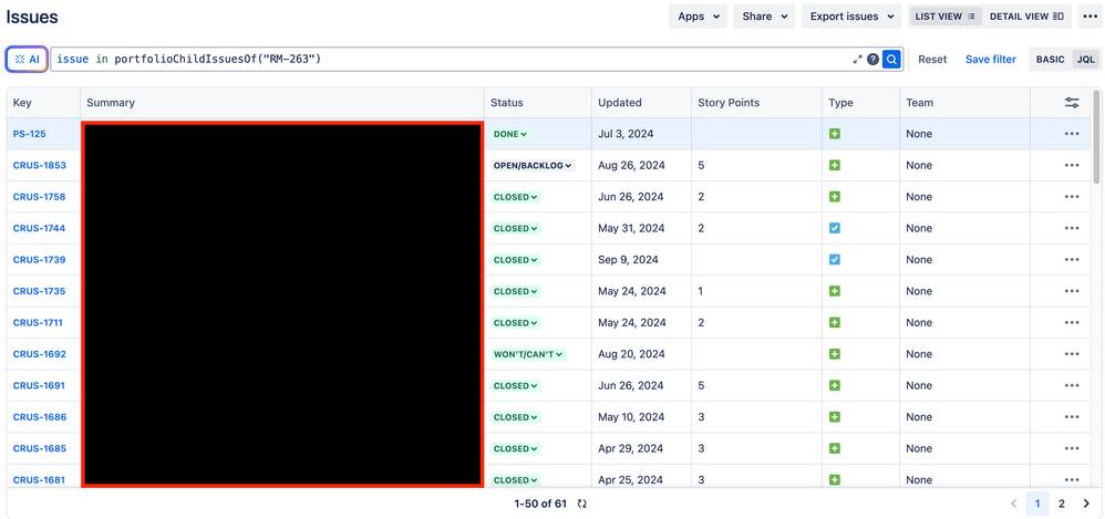

When I run the JQL from the JQL query line I get 61 results.

Can you show us the results of the JQL query using the issue key shown in the log? I want to see the Issue Types for the issues in the results. The other information can be obscured.
Hi Trudy,
This is what I am getting...
It is a mix of Story, Task, Bug and Epic issue type.

What is the Scope of the rule from the Rule Details page?
The Lookup Issues action is able to retrieve issues only from the projects that are listed in the rule Scope.
I notice that the issue that triggers the rule in in the RM project. In the image you provided from the Issues screen I see that the issues being retrieved are in other projects. In order for the Lookup Issues action to retrieve those issues you will have to make the rule a Multiple Project Scope rule and name each of the projects that might have an issue under the hierarchy of the RM issue. Or you can set the project Scope to Global to search all projects in Jira.
You might then want to add Conditions after your Trigger to ensure that the rule will continue only when the trigger is activated by changes in your intended source project vs. all the projects in scope.

If you put the lookupIssues code into the Advanced search function and then use the value of the Initiative key - does it return anything?
In other words, execute this as a filter:
issue in portfolioChildIssuesOf("RM-263")
Good morning John,
Yes, when I execute the JQL in the Advanced Search it returns 61 issues.
Which is why I am surprised that the lookup issues is giving me the message that no issues were found.
