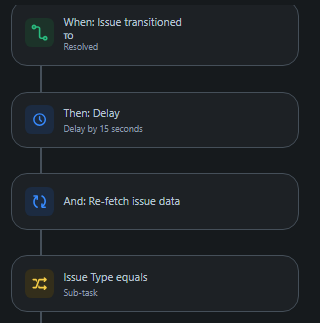

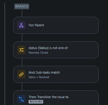

Hi @Sameeksha Shetty ,
you can achieve the 1 & 2 by using the automation.
For the 1st one, you can configure the automation like below:
