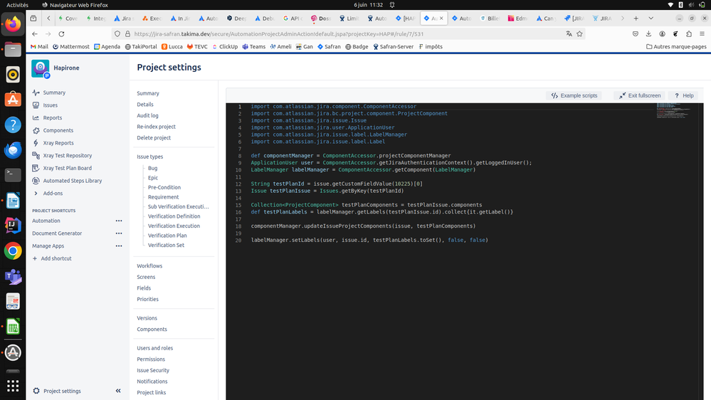

Capture d’écran du 2024-06-06 11-32-01.pngCapture d’écran du 2024-06-06 11-32-19.png
Here is an image of my complete automation rule with the script that I use.
I think the problem is probably like you said that the action performs by XRay is not considered as an event by Jira Automation, so  it does not trigger the rule.
