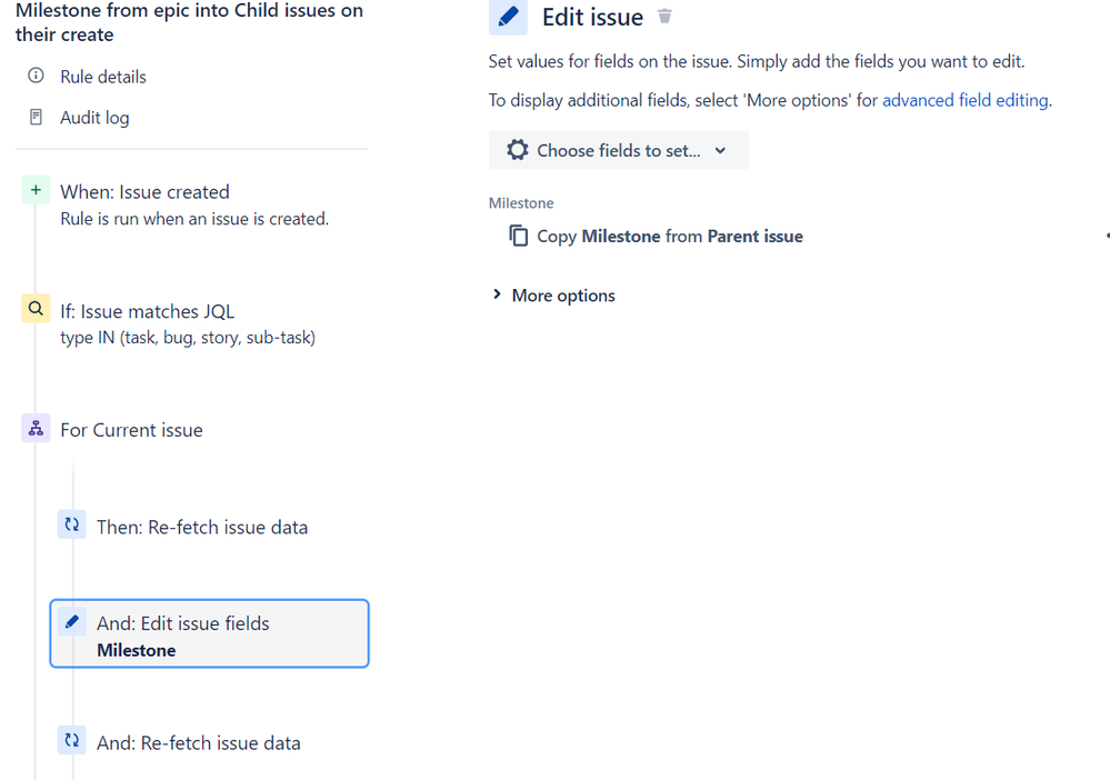

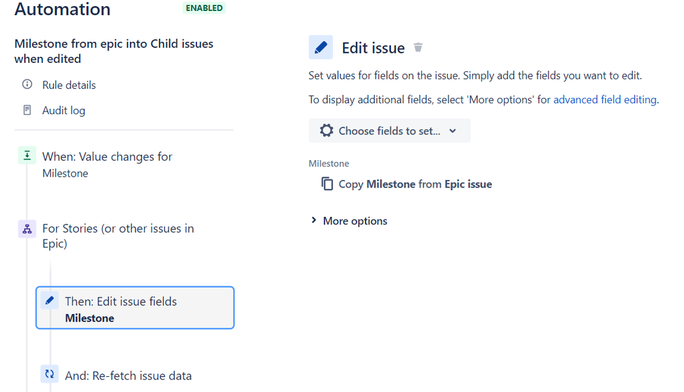

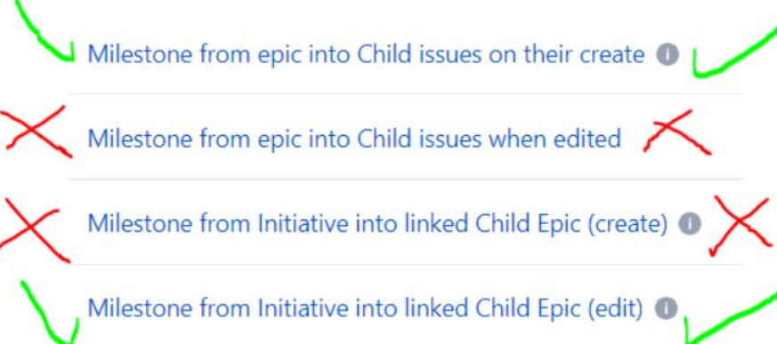

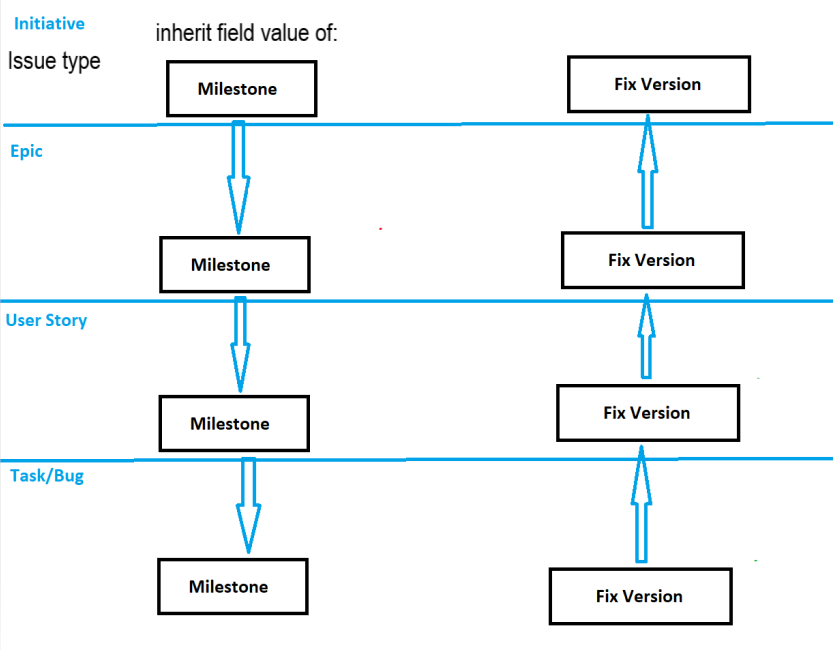

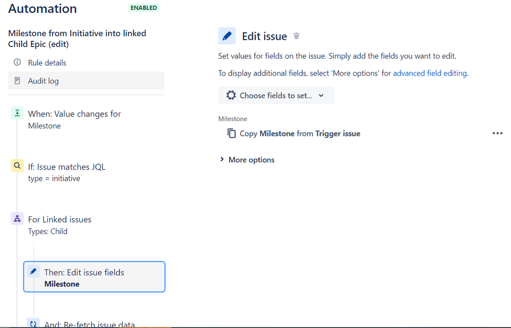

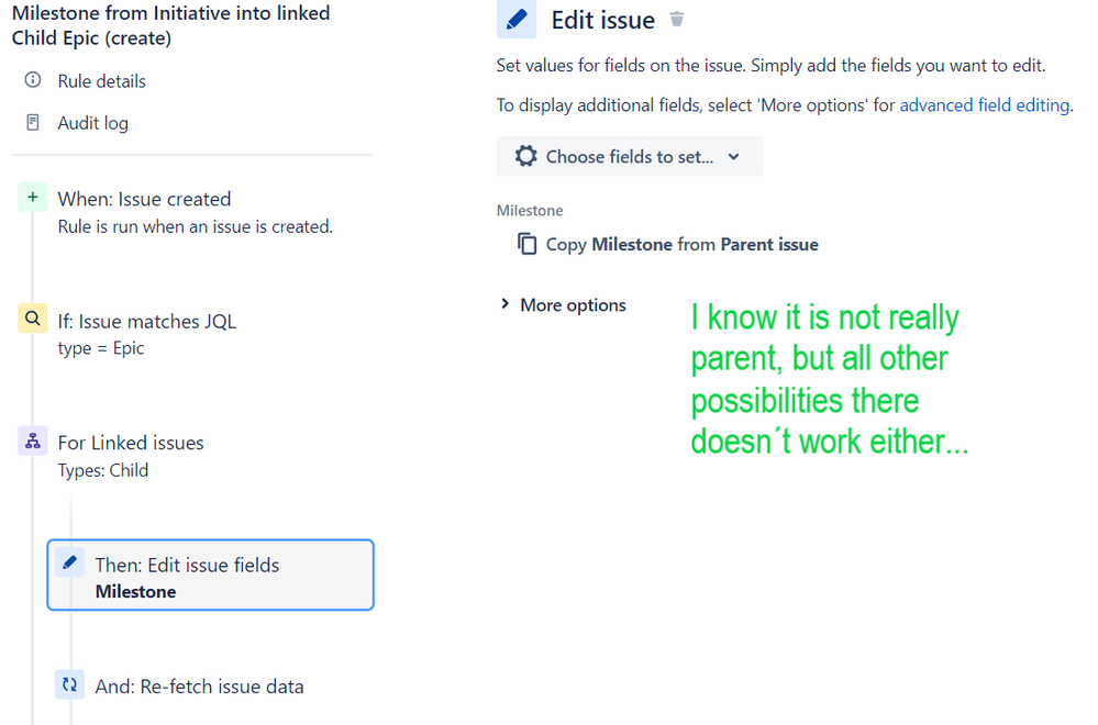

Hi, struggling with setting automation rules to update a field in issue type hierarchy as on annex. One set of rules to set the field on create issue and second when updated. It works just partially and non-functional rules have no action in logs, so it looks like Jira automation doesn´t count its own action as an event. There might be also some human mistake, of course. Could you give me some hint/advice, please?
Problem between Initiative and Epic is that there is just custom classic link between them (called child/parent, but it is not the Parent link as with parent link cannot be filled by automation and I need to be that link created by automation). Enclosing also print screens of the rulesworking_2.PNGworking_1.PNGnot working_2.PNGnot working_1.PNGmilestone and fix verion inheriting rules.pngmilestone_red non working.PNG
