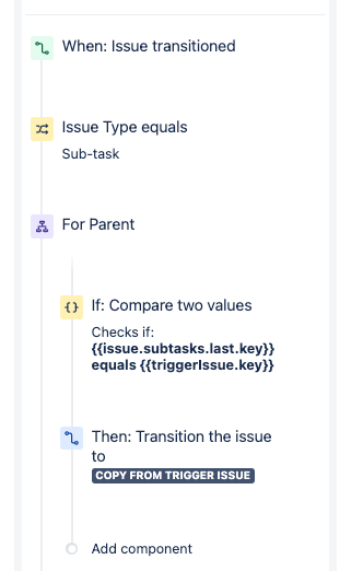

I did a bit of experimenting and it appears that this smart value will refer to the subtask that is "last" in the visual list of subtasks in an issue.
{{issue.subtasks.last}}
I am not positive that is 100% reliable. I did not do a lot of testing, and only tested with a Company Manage project. I did try reordering the subtasks in an issue and rerunning an automation rule to print {{issue.subtasks.last.key}} and it was consistently printing the issue key of the last task in the list.
So, you could use an automation rule like this:
"Copy from trigger issue" works in the last step if your subtasks and parent issues use the same workflow/status values.

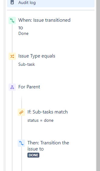

Alex Koxaras -Relational-
May 23, 2023
Hi @Sara Chaves and welcome to the community,
Use the following rule:
