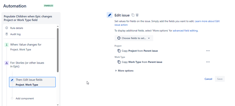

Looking for some automation rule help - I have a rule for when an Epic change 2 custom fields (Project & Work Type) then populate that value on all the Epic children. My rule won't populate the sub-tasks though. Suggestions on how to make the rule work for all Epic child cards & Sub-tasks?
Here is the rule that partially works:
Hi @Ann Rumenapp ,
As it seems your branch searches only for stories, try using JQL branch and using JQL "parentEpic = {{issue}}". The parentEpic function looks for all the tasks in the epic and their subtasks.
THANK YOU so much! That worked. I'm just learning/testing out how to write automation rules.

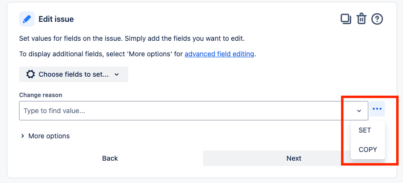

I'm trying to use this rule and your suggestion, but the field I want to use does not have the options 'Copy from Epic, Copy from Parent. ' This field's type is Select List(Single), so it just allows me to select from one of the defined options.
Do you know any other way to take the option selected in the epic and populate all child issues with it?
I tested it on select list and it works for me.

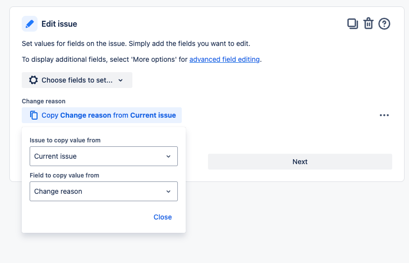

You need to first click on three dots and select copy:
Then click on "Copy customfield from Current Issue" and change the Issue to copy value from to the issue you need:
