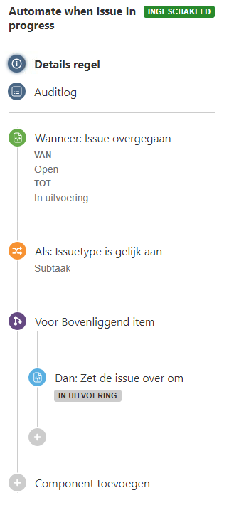

  1. First rule:
    When the user moves a subtask from 'To Do' to 'In Progress' the status of the story will be updated to 'In Progress'

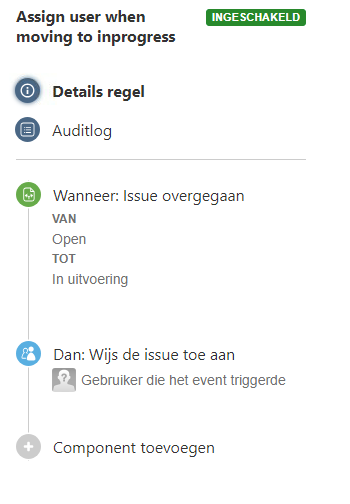

  2. Second rule:
    When the user moves a subtask from 'To Do' to 'In Progress' the user who did the action will be assigned automatically to the subtask

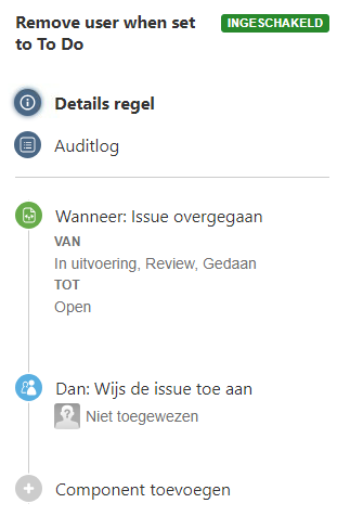

  3. Third rule:
    Whe the user moves a subtask from 'In progress', 'in review' or 'done' back to 'To Do' the subtask will be automaticall unassigned.
I started with rule 1 and when activating the rule it only updated after a refresh.

You can see the rules in the screenshots.

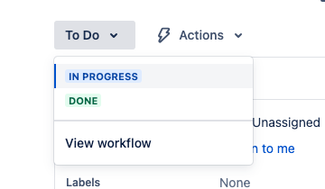

I'm not understanding why you have applied the first rule. The workflow transition built in actions should change the status to In Progress.

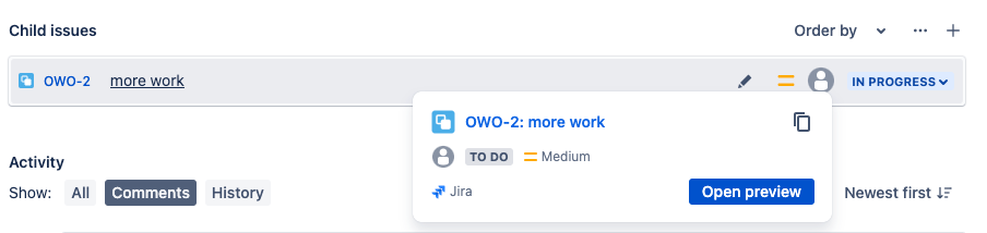

But if you hover over the sub-task in the original window, the pop-up view will show your changed status.

I am intending that when I move one subtask from TODO to IN PROGRESS, that the status of the story where the subtask is in will be automatically set to INPROGRESS.
I use branche function to be able to get to the parent of the subtask to change the status. I read somewhere that this could give an issue with updating directly.
