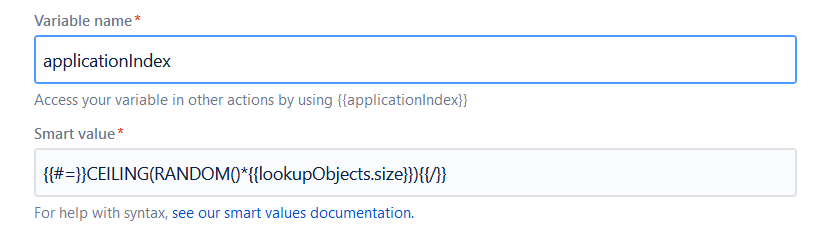

First I'm creating a lookupObject, then I use the size of that lookupObject to get a random number between 1 and the total number of entries of the object, like so:

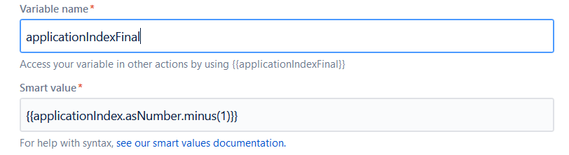

After that I use another variable to do minus(1) since a want a value between 0 to the size of the object -1 (to access the index)

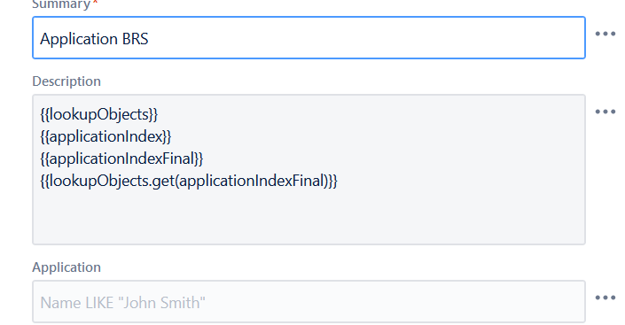

Then when I'm creating the issue I'm trying to use the applicationIndexFinal to access the desired index in the lookupObjects:
But this is the part that is not working, when I create the issue both the {{lookupObjects}}, the {{applicationIndex}} and {{applicationIndexFinal}} write values on the description, but not the {{lookupObjects.get(applicationIndexFinal)}}.
Example:
lookupObjects will write: Server1, Server2, Server3
applicationIndex will write: 2
applicationIndexFinal will write: 1
And then nothing more is written.
How can I use the applicationIndexFinal to access the value I want inside the lookupObjects?

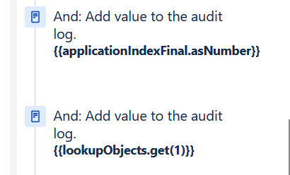

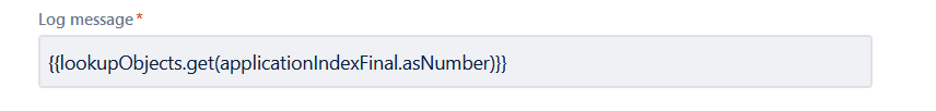

Thanks for your fast response, I've already tried this:
{{lookupObjects.get(applicationIndexFinal.asNumber)}}, but still nothing :/

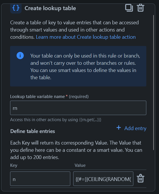

Hello, haven't commented on this issue for a bit, but I've talked with support and there is a solution with the use of a lookup table with the lookupObjects and using the random function for the key. Thanks your help! :)
I am glad to learn the support team offered an idea...and I believe the only reason that will work is Lookup Table's implementation of the get() function can take a parameter, unlike most of the other automation rule functions.

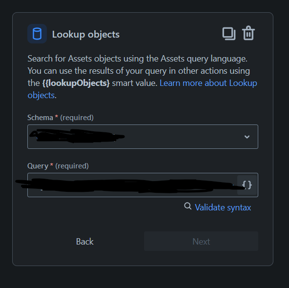

First get the list of assets from which you want to randomly select:
Then create a lookuptable, like so:
This is the code inside the Value field:
{{#=}}CEILING(RANDOM()*({{lookupObjects.size}} - 1)){{/}}
After that, to access the randomly selected asset use this:
Hope this helps!
